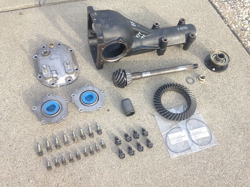

STi R180 rear differential (final drive matching that of the transmission)
STi R180 rear axles
2004 STi R180 rear hubs
STi / WRX 4/2 pot brake calipers
WRX 4 pot front brake rotors
DBA Group N rear gravel rotors or later model JDM GC8 R180 2 pot brake rotors

Final Drives:
'02-'05 USDM WRX 5MT: 3.54
'04-'05 USDM STI 6MT: 3.90
'06-'07 USDM STI 6MT: 3.54
Based on these final drives, it is possible to use an '02-'05 WRX 3.54 final drive R160 rear differential with an '06-'07 STI 3.54 final drive 6MT transmission. Other combinations of trans and rear diff will require the ring and pinion on the rear differential to be swapped to the proper final drive.
