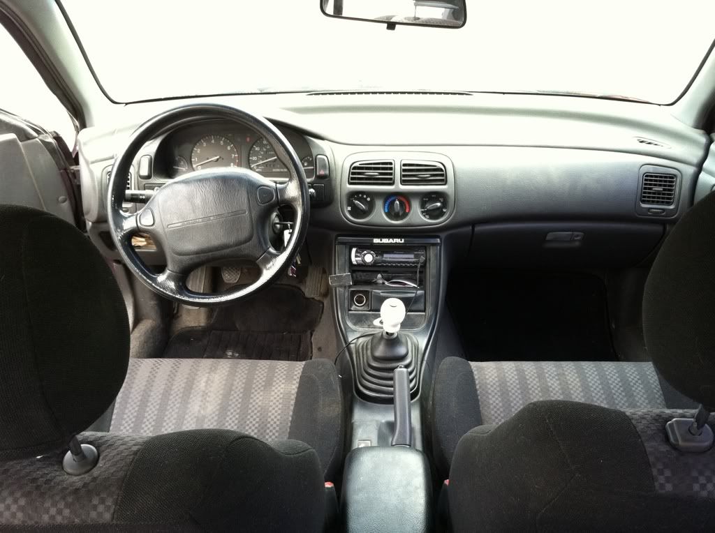

Clean Interior

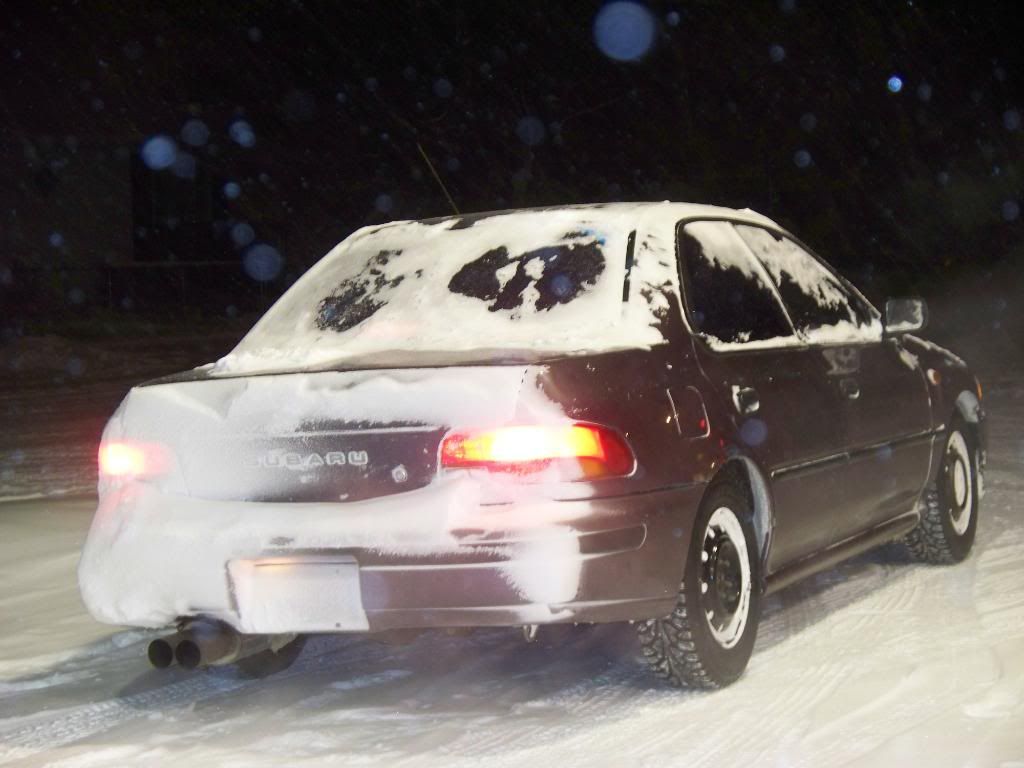

Winter tires on

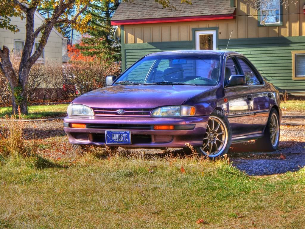

Installed KYB GR2 with Tanabe GF210 lowering springs. Thanks for the deal from member Knoonz. Onto the pics
Still in great condition with 10K on them
The suspension was probably a 1.5in drop or more. It sits perfect now. Tires fill the wheel wells very nicely. I will have to find a fender roller for the rear as it does rub a little. Very pleased with the results.
The tire rub mark. I'm sure after a little fender rolling it should tuck snugly.
Before side shot
After

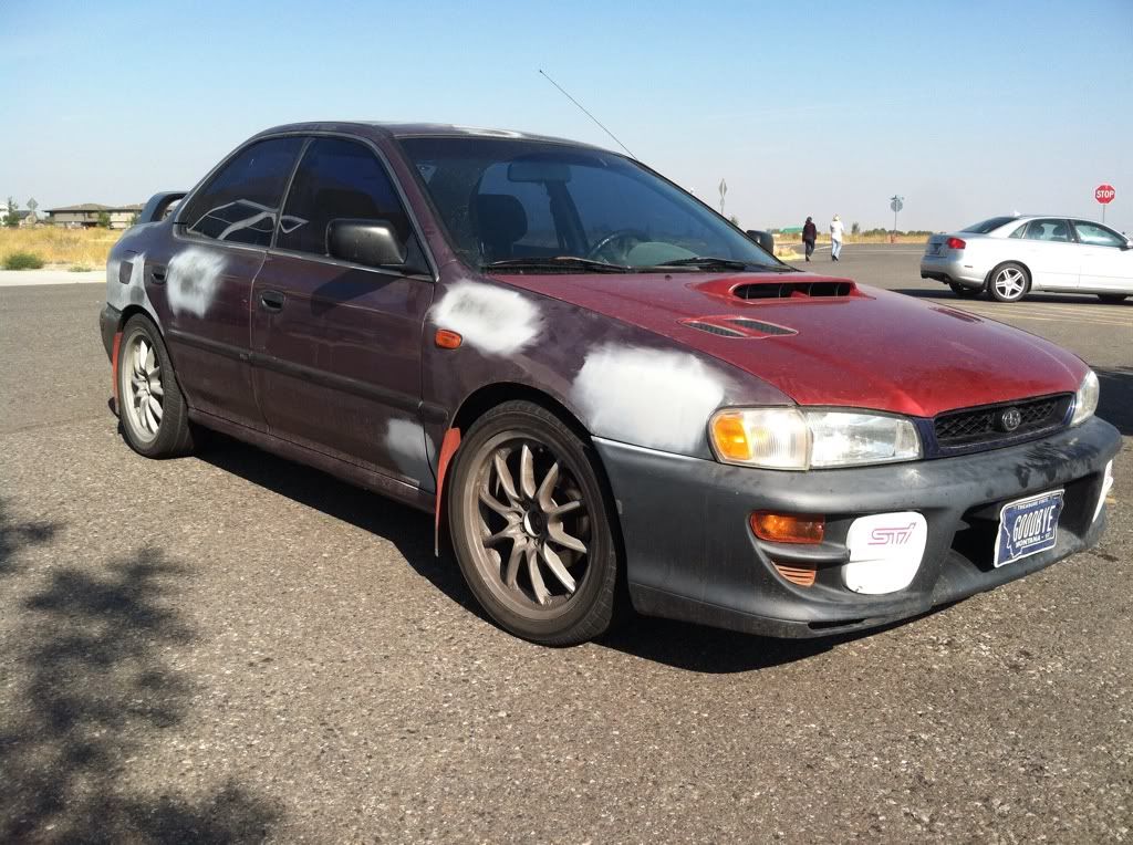

Got the Massive Intake on the stock tube. Fabricated an aluminum shield to prevent splashing through the holes on the fender. Also created wall shielding intake from engine heat. Made a huge difference in power and how the engine ran.
Next is a 2.5 header and exhaust. Better injectors. This car is amazing though. I will never sell it

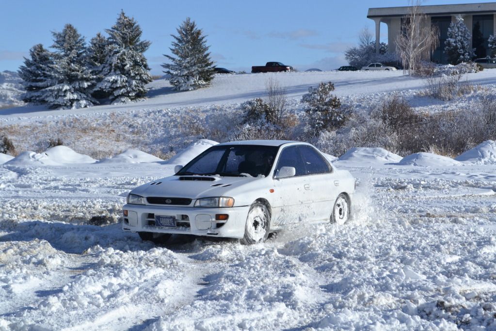

Winter is coming and this bad boy is ready for it. Got to get sideways on some wet pavement corners. It can power through once you actually break traction and get sideways. Gonna put the smaller winter tires on it and it will have even better better torque

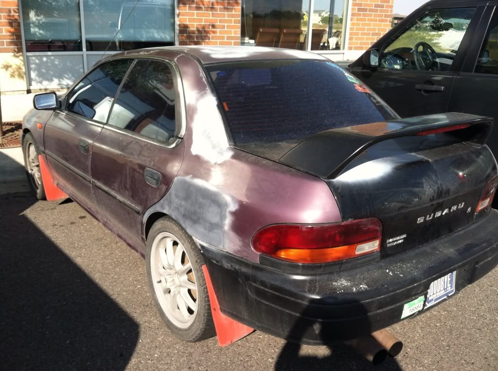

u better take care of that rust spot before it spreads. besides that rust spot looks pretty clean.
YaY i get to learn body work! haha yeah i will be gettind rid of that and the massive dents i got from a hail storm we had a month ago.
