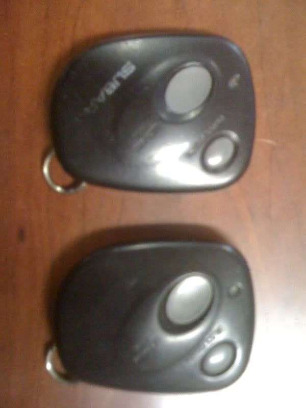

Picked these up from another forum and I was wondering if these will work for my 01 RS. The post said they would but after searching the part number (88035AC230) I see that they might have been for an older Legacy and still other links say that they will work but I have read that there were different manufacturers for Subaru and they might not all be compatable. Thanks in advance for your time.
#3 · (Edited)
Those are some old FOBs but they still only have a 2 button setup so this may work:
To program a fob to the factory security system, you have to push and hold the little reset button under your dash until the car chirps 3 x and goes into learn mode. Then it'll program itself to the 1st button you push on your fob. This should be the "Unlock" button.
Also, should those not work, you can always just Ebay CodeAlarm KeyFOB's and you'll find plenty of the OEM '01 style fobs...
