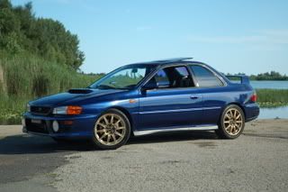

Just an update. I did just install brand new Subaru oem struts and Subaru oem front coil springs with new Subaru rear struts with Moog oem equivalent rear coil springs (Factory ride height). My suspension is completely stock and I’m running 2004 Sti BBS wheels with 225/45 17” tires. The front wheels/ tires have plenty of clearance and also clear the fender no problem. The rear tires clear the fender no problem also...plenty of gap there even on hard cornering. The rear tires do come close to the rear struts, but don’t rub...I’d say about 1/4” gap. The rear wheels clear the rear struts no problem. I’m using Goodyear F1 summer tires right now on my gold BBS wheels.
Here is a pic of how it stands now. :D
