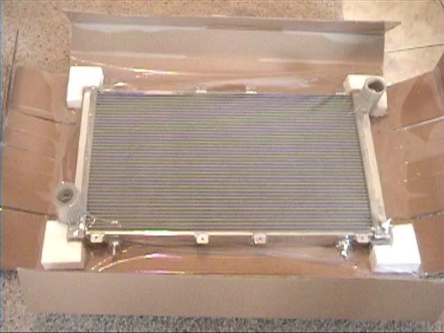

The packaging jorb done by Koyo:

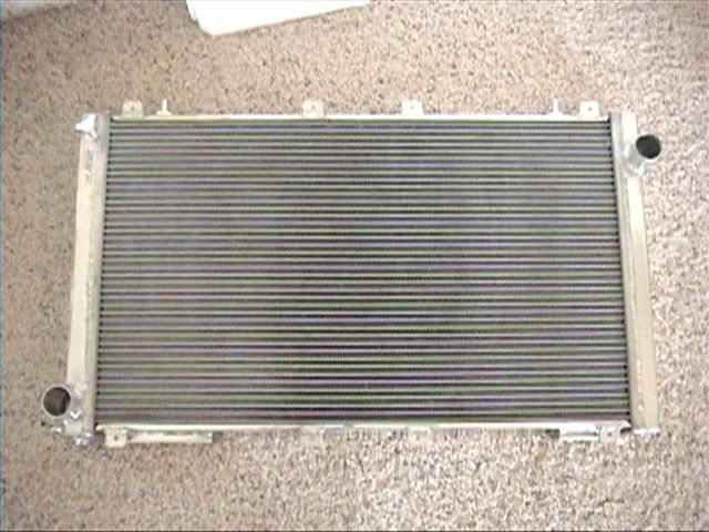

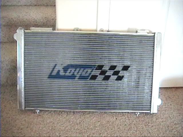

And the radiator out of the box:
I thought it was going to be a 36mm core, but it's a whopping 53mm thick! That's over twice the JDM core (25mm) and 3.5 times as thick as the RS core (15mm)! Hope it fits!

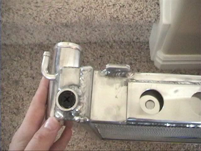

The top connections all look to match OEM:
Although Koyo does add that hole there which is plugged by that black plastic screw. Helps to burp the radiator I suppose but I don't know if I trust a plastic screw.

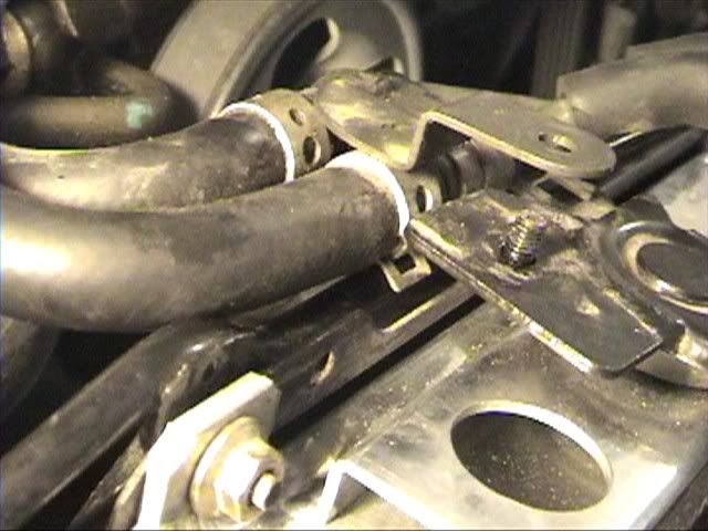

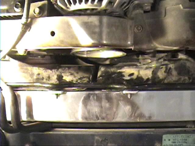

And the top-down view, to see how little space is left in there:
The power steering cooling lines still prove to be troublesome. They are metal lines and certainly not in the mood to bend. They are used to getting around a thinner radiator but this one seems to be just too thick:
There you can see that between the 53mm radiator and the coolant escape hose the power steering lines just can't seem to be seated flush on the top of the radiator. If I leave them like this their little foamies contact the hood, but don't interfere with closing it. -1 on the bling factor though; if you know how to work around please let me know.

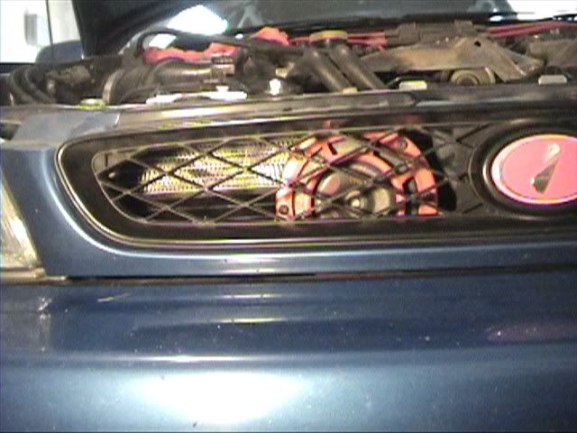

And here is all you get to see of it when the hood is closed:
See that majesty?
So there you go. If you have a JDM GC8 Impreza, the Koyo R1819 (Legacy 2.2L Turbo Sport Sedan) radiator WILL fit.
