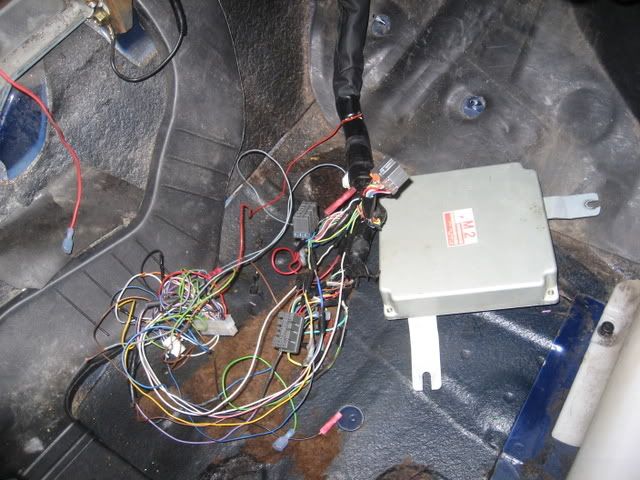

3) He tried to install a PP6 and blew a fuse (he thought the ECU was fried), and lef the harness looking like this

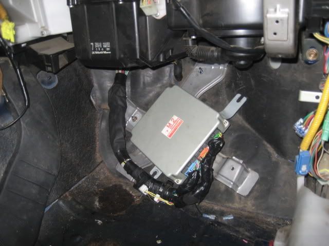

The harness looks like this after i fixed it, but i need to get rid of that short, but no one sells shielded wire
