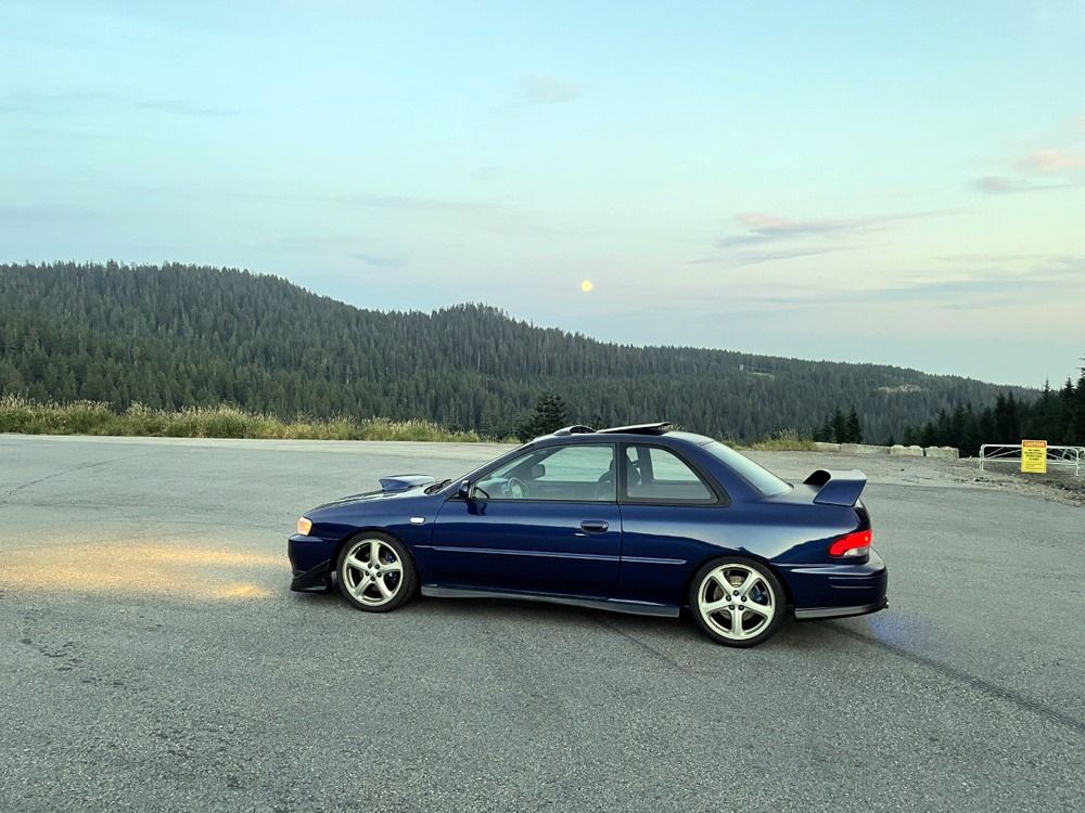

UPDATED MOD LIST:
-Blue grill emblem, otherwise de-badged
-Grill-mounted dual Hella Hi-Lo horns
-DIY urethane front lip
-Clear turn signals, corner lights & side markers
-Nokya S1 headlights & foglights w/ Autolumination ceramic connectors & DRL delete
-(Almost) All Autolumination LED lighting
-Zola/Rocketz carbon fiber hood & trunk w/ High rise hood scoop
-PPG windshield w/ blue sun strip
-OEM sunroof deflector
-OEM remote fuel door conversion w/ JDM flat fuel door
-JDM tail lights w/ Daily Driven Garage gaskets
-JDM rear bumper spats & '07 STI lower diffuser
-Brushed aluminum dash kit & gauge bezel
-Blue Autolumination LED dash lighting
-OEM compass pack & Autometer Ultra-Lite boost, volt and oil pressure gauges
-'05 STI steering wheel w/ JDM variable wiper switch & blue STI key
-WRX black/aluminum pedal covers w/ Peugeot 206 deadpedal
-STI piston shift knob w/ Kartboy short throw shifter & bushings, black leather/blue stitching shift boot, handbrake boot and armrest cover
-Colour-matched ’14 BRZ front seats w/steel seat brackets & blue pin-stripped OEM rear seats
-Denim cabin & trunk carpet w/ insulation-delete & liquid rubber-sealed cabin & trunk
-Relocated SVX battery
-CompuSTAR keyless entry alarm
-Clarion NX602 head unit w/ video-handbrake bypass
-JBL GTO18T 1” w/ crossovers, JBL GTO626 6.5” 2-way, JBL GTO628 6.5” 2-way
-JBL GTO5355 5-channel amp w/ Remote Bass Control, Earthquake Sound GLI-200 Kleaners & GTO1214D subwoofer in custom enclosure
Powertrain
-Original EJ251 w/ Turbonetics T3/TD04E turbo 0.62ar 46 trim (I believe), cruise control delete & Tial 38mm wastegate w/ 5 psi spring & stainless open dump
-Spearco (I believe) 3” top mount intercooler, aluminum charge pipes w/ 3" cone air filter & red hoses, STI throttle body/intercooler coupling, Honed-out throttle body w/ coolant by-pass & Greddy Type RS BOV
-Customize OEM oil pan w/ Russell stainless braided turbo drain back & OEM magnetic drain plug
-Link G2 ECU w/ STI pink injectors, Aeromotive FPR & Autometer Ultra-Lite pressure gauge, '04 STI fuel pump & Aeromotive 10 micron fuel filter
-NGK BKR7E gapped to 0.0025" w/ NGK blue spark plug wires
-Borla UEL stainless header w/ DIY 2" stainless up & down pipes, Hollow 2.5" Magnaflow universal stainless cat, DIY 2.5" mid-exhaust & BPM 3" stainless over-axle muffler w/ A'PEXi hangers
-Billet ‘STI’ oil cap & rad cap w/ K&N valve cover vents
-California A&S 90A alternator & A/C delete
-DIY grounding kit & aluminum rad cooling plate
-Megan Racing engine and transmission mounts
-Centerforce Dual Friction clutch w/ reinforced clutch fork, ACT 12lbs street flywheel & OEM diff cover
-Castrol Edge 5W50 & Redline drivetrain fluids
Footwork
-Megan Racing Street coilovers
-JDM Legacy B4 rims w/ 215/40ZR17 BF Goodridge KDW tires & McGard blue lugs
-Whiteline front & rear strut bars
-Whiteline 22mm front & rear sway bars w/Whiteline endlinks, bushings & brackets
-Whiteline steering rack bushings, tie rods & ball joints
-Whiteline front control arm bushings
-OEM 4-pot front calipers w/GD WRX cross-drilled & slotted rotors, dust shield deletes, Russell braided lines & Hawk HPS pads
-Megan Racing rear trailing arms & adjustable rear control arms
-Whiteline rear subframe lock bolts
-3rd gen Legacy rear calipers w/3rd gen Legacy cross-drilled & slotted rotors, dust shield deletes, Russell braided lines & Hawk HPS pads
