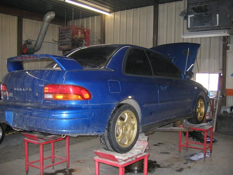

And here she is at the body shop I worked at the day I brought it home
After this, I began the process of rebuilding my new purchase.

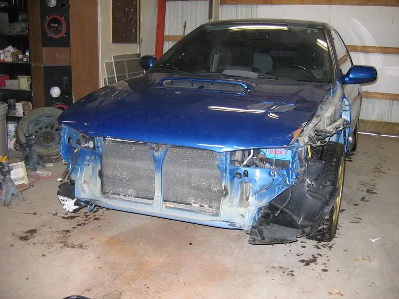

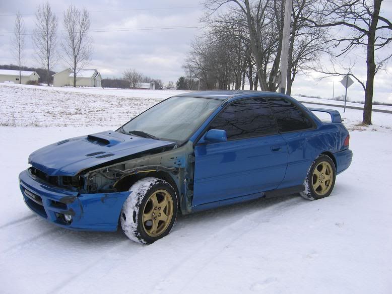

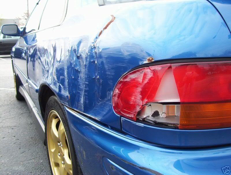

So, with 65K on the clock, this car was pretty fresh but had obviously seen some violence. The previous owner hit the center divider on the highway causing the obvious body damage as well as bending the rear suspension up and the radiator support/front clip was off by about 1.5 inches.
I happend to work at a body shop at the time so It was easy for me to asses the damage...

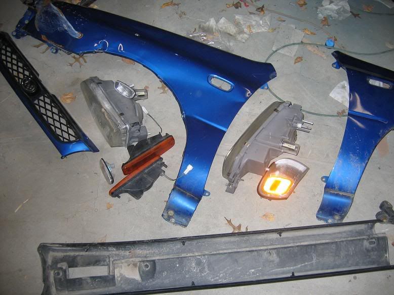

I began tearing into the front body work too, getting the car ready for new fenders, bumper, hood and a headlight.

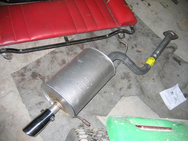

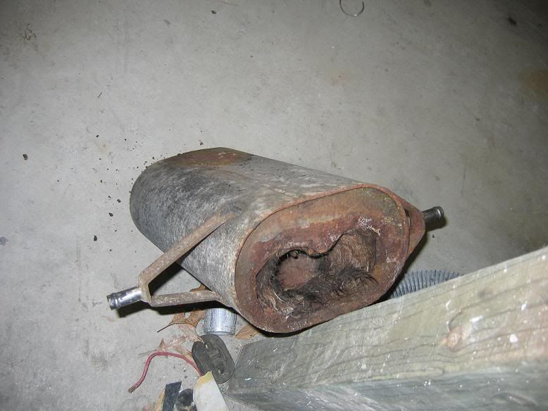

I started buying parts, first off with a new muffler (OE Replacement) since the mild steel stromung the previous owner had installed was rotted to shit and new lateral links for the rear drivers side. The rear link was a right side but I cut off the sway bar mount and had it re-welded.

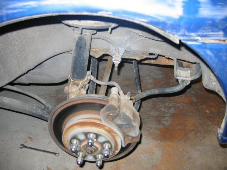

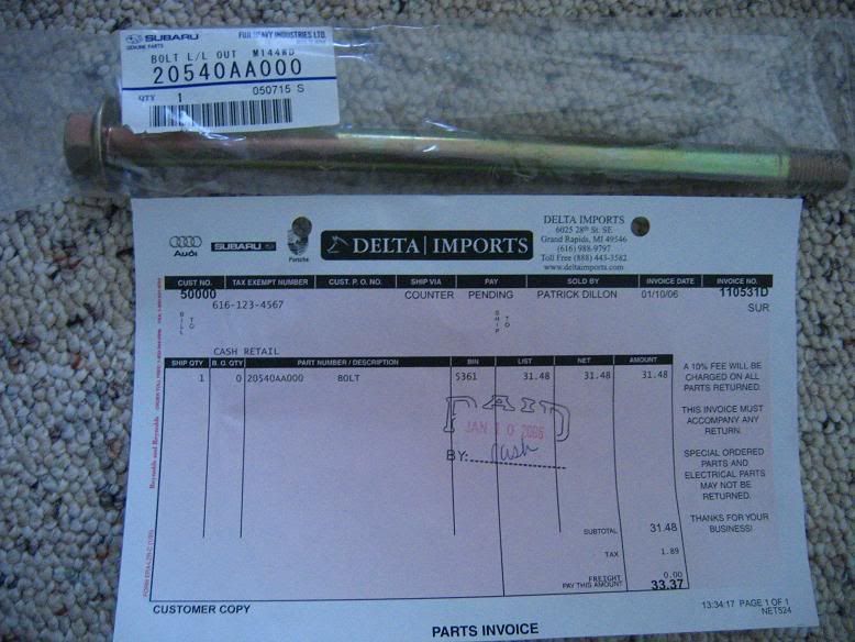

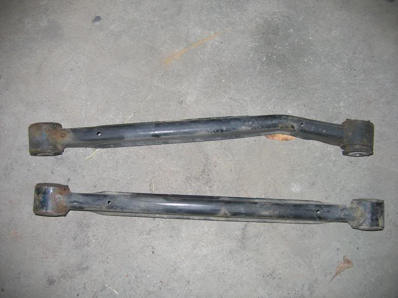

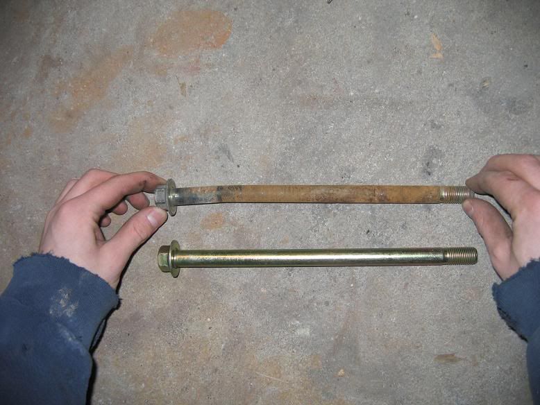

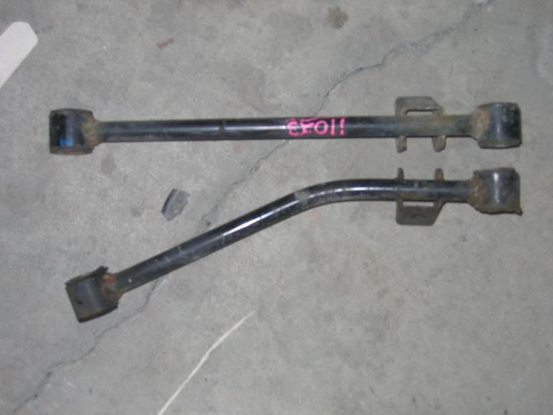

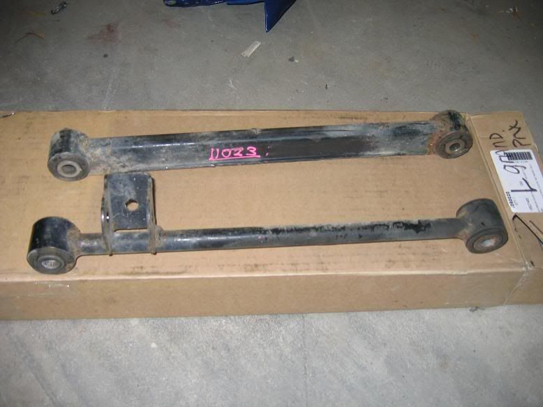

The first thing I repaired was the rear suspension. Heres a comparison photo for you to show just how bad the lateral links were...
Also bent the long bolt that attaches them to the knuckle. $33.37 for the bolt!
So! with the suspension done, It was time to take it for a little run up and down the street, to see how much BETTER it would drive. At this point, the car was at my good friends house, a couple who had taken me in a couple times as a kid and young adult. The guy who owns the shop, John, would eventually do the body filler and paint on the car. Anyhow, his shop is at the bottom of a hill and my car had bald Kumho summer tires on it and yet I still made it up the hill. My first time experiencing the beauty of AWD!
Next up I purchased a used front bumper off of a member on this site, along with clear turns and fogs. I also picked up a new rear tail light from a local parts place and a new headlight from another member. New fenders and hood purchased through the body shop I worked for.
Test fitting...

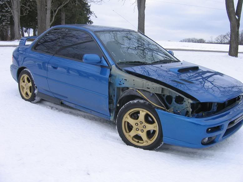

Next up was the biggest project on the car...the rear drivers fender. Ugh...what a BITCH! Our method of attack was to bend the sheet metal back as close as possible and smooth it out with filler. This involved using alot of different hammers, slide hammers, dolleys, prybars and patience. My friend John, a pro body man by trade, began doing the filler. We were able to keep it no thicker than a quarter inch across the whole fender.
Heres what we started with...
Onto the Bondo...
Meanwhile, I was sanding and mocking up the front end sheet metal
Soon I would get my first taste of fresh Rally Blue Pearl when we cut in the underside of the hood. I also learned how expensive paint was. $250 for two quarts of PPG Basecoat!
Next, the rear fender was ready for Primer and final sanding before paint.

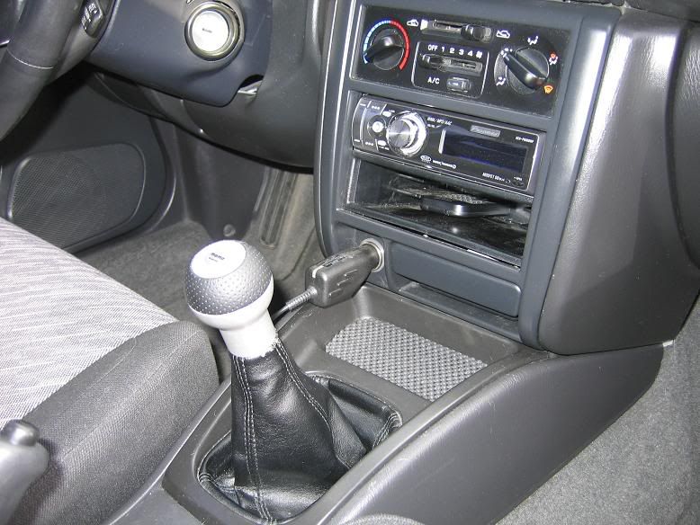

Okay, so next came a couple of small mods. Momo/Subaru shift knob for my 19th birthday, Hella 500 fog lights and a set of 02 WRX wheels for the winter. Wheels got painted gold. Pics plus random...

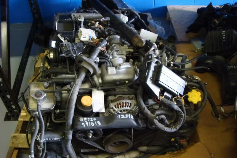

Thus begins the next chapter in my cars life: Swaping my old ej25d for a 96 WRX EJ20G.
Im going to use this journal to help me organize all of my info and to help those who may do a similar swap in the future and Also for those who wanna lend a hand.
So far, I have sourced diagrams from northursalia ( http://www.northursalia.com/ ) and from Subadave ( www.suberdave.com )

My engine set is from a 96 WRX wagon. Can anyone verify that I have the right diagrams?

Got the set from ECS. Great guys to work with, got me a good deal and a good product. It gets delivered today and im stuck at school an hour away!

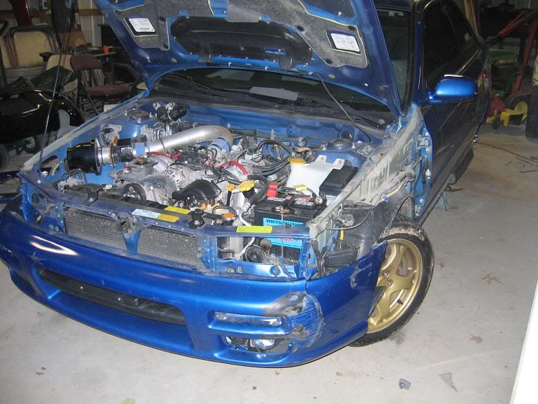

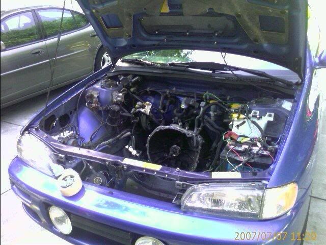

Pulled the motor last night and I have a bunch of pics. I had a lot of helping hands and we had some fun...
Alcohol injection installed...
Can you tell im excited?
Obligatory ridiculous picture...
A couple problems have yet to be resolved which keep me from installing the new motor.
