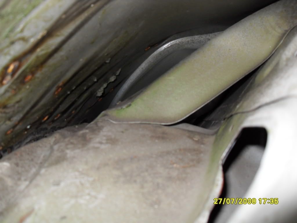

First off, screw taking it to a mechanic or a body shop. I did and he said that it looked like i was filled with body filler and that it was just cracking.
He also said that he/she/it would have to throw it on a lift to see the extent of the work.
Here are some photos of the crack first.
With that said, what about the inside (where you remove the trunk liner) drivers side rear quarter panel.
It looks crusty as ****!

It just looks like there was some rust around what I'm assuming is the rear wheel well and that they did a bad job fixing it, as the bondo or whatever they used to seal up the holes is cracking. You should take some pictures from further away though so we can see what's going on. Some of those are just too close up.

in the 2nd to last pic, quarter panel, looks like maybe a dent was pulled or holes were drilled for some reason. Looks like the filler leaked through the holes, hence the clumpy ooze. whoever fixed dent couldn't get in there with a dolly to support the back of the panel to hammer out dent.
