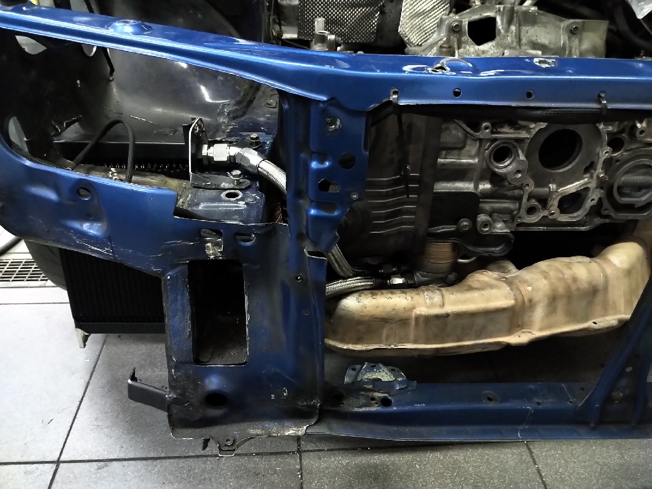

Engine bay
And its current state
Yep, I stripped it completely, car is currently in the rally shop undergoing chassis preparation (stripping seams and paint), after which I am going to seam weld it and slowly start assembly.
