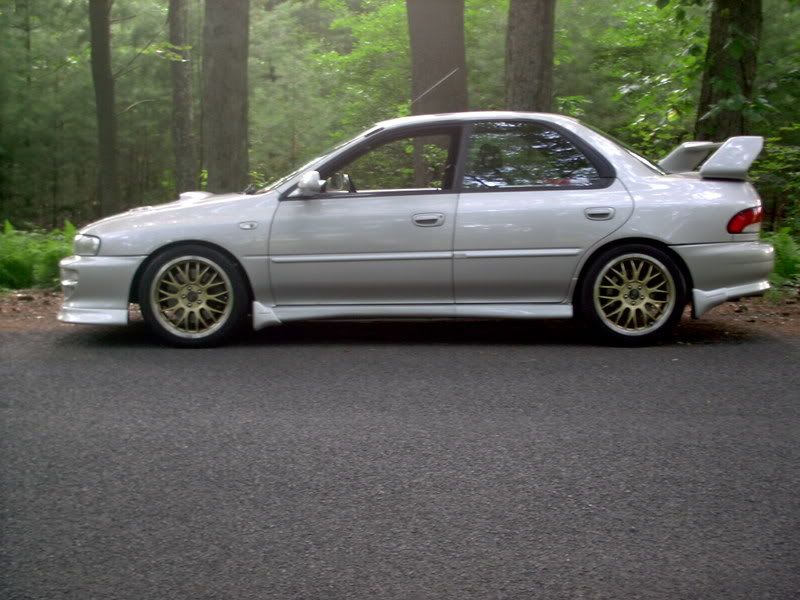

Hey guys so I'm about to pickup a set of side skirts with the front aeroguards and the rear spats w/aeroguards as well. I'm planning to get a set of rally armor mudflaps as well and was wondering if there was any issues fitting the mudflaps with the aeroguards (front & rear) in place by offsetting the flap from where it was typically rest against the sideskirt/bumper & rear bumper/spat. I really need a set of mudflaps for where I live due to the terribly dirty country roads I have to drive on going to work and this would greatly reduce all the mud/dirt streaking across the car. Thanks for any info!
btw here's a picture of how the car would look for reference.

You need longer hardware to reach through the guards, they'll push the flaps forward towards the tire a wee bit but ive seen plenty of people run both.

Weird.. was just thinking about this as well.. I pulled my spats off since they looked like they were sagging and not really installed well previously... after pulling them off, there were paint issues underneath (they rubbed the panels underneath and the paint flaked off with it).
Gonna try to reinstall them tomorrow night/this weekend to re-cover the bare spots, and then do the mudflaps over them! After holding them up to the car with the flaps on it, it looks like the spats will need to go in between the flaps and the rest of the body panels.
Thanks in advance for the info!

I am running rear spats and mudflaps, just longer screws, not to hard to install, a second pair of hands help a lot.

No I do not, but I do know they were about a half inch longer than the provided ones.

thanks tricky...mind taking a full side pic of the car when you get the chance? going to debate on doin the side skirts/guards now that i see it kinda.
