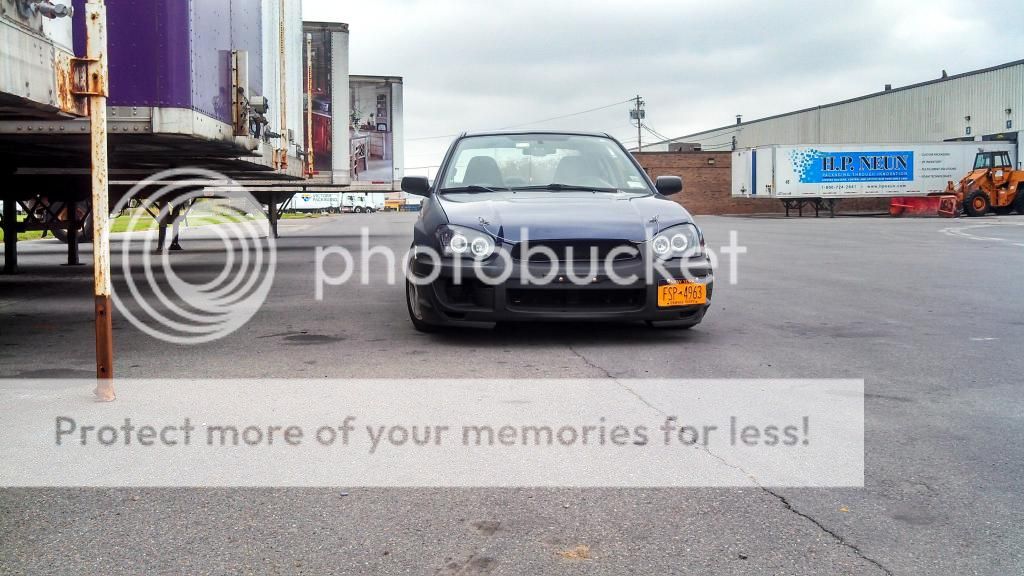

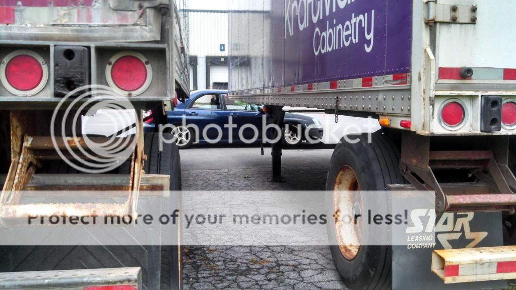

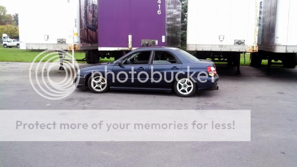

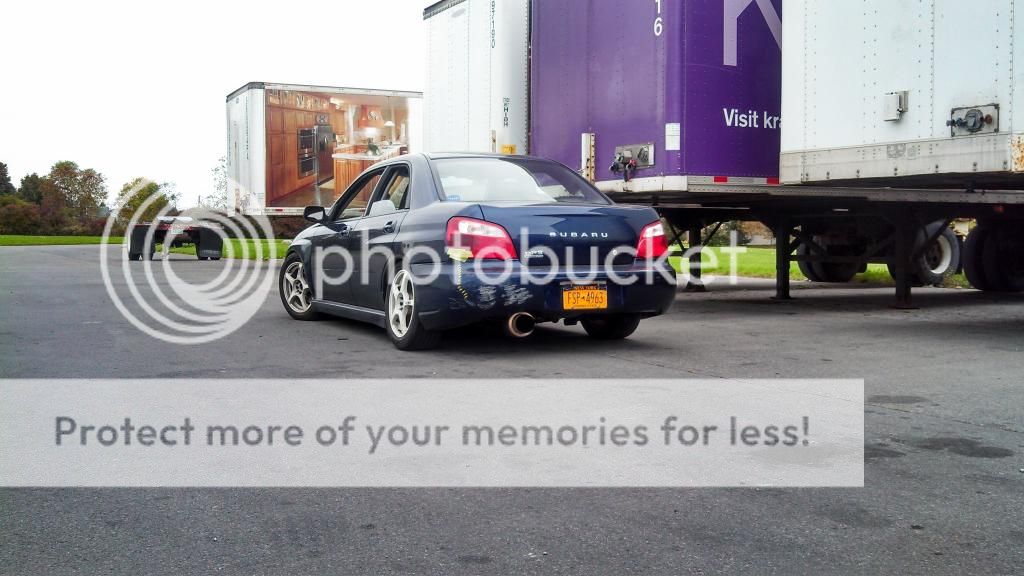

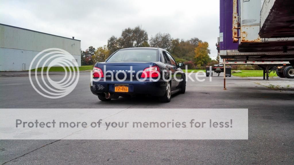

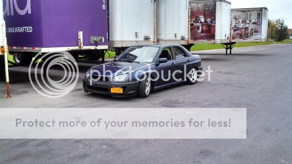

Sold the Protege and bought the car Ive always wanted...
This is my 2005 Impreza 2.5RS. Ill keep this thread updated with the work I do to it. Since Im still paying it off, mods will come but not for a little bit. Till then it will just be little things here and there. First major thing Im planning hopefully for next summer is a drop on coilovers.
Mod List:
- Engine/Driveline:
Tsudo 2.5" Cat-Back exhaust
Tsudo 2.5" High Flow Cat Pipe
Tsudo 4-2-1 UEL Header: Wrapped
NGK Spark Plug Wires + NGK BKR6EIX Plugs
Grimmspeed Lightweight Crank Pulley
Silicone U+L Radiator Hoses
Agency Power Short Shifter
Blox 490g Neo Chrome Shift Knob
- Wheel/Tire:
-----Summer-----
16" Enkei RS5s: Blaze Yellow
Federal 595 R-SR: 205/50
-----Winter-----
16"OEM Steelies
Blizzak WS70: 215/55
- Suspension/Brake:
Raceland Ultimo Coilovers
LGT Rear Caliper Swap
R1 Concepts Premium Drilled and Slotted Rotors (F+R)
EBC Green Stuff Pads (F+R)
Stop-Tech SS Brake Lines (F+R)
Grimmspeed Master Cylinder Brace
- Exterior:
STI Replica Front Bumper
STI Front Lip
Projector Headlights/Dual Halos
- Interior:
Kenwood KDC-BT555U Head Unit
- Other:
AC Delete
Rear Seat Delete + Retaining Net
Interstate Battery Relocated To Trunk
Z1 Performance Timing Belt/WP Kit
Grimmspeed Hood Struts
Sickspeed 3" Neo Chrome Shift Knob Extension
