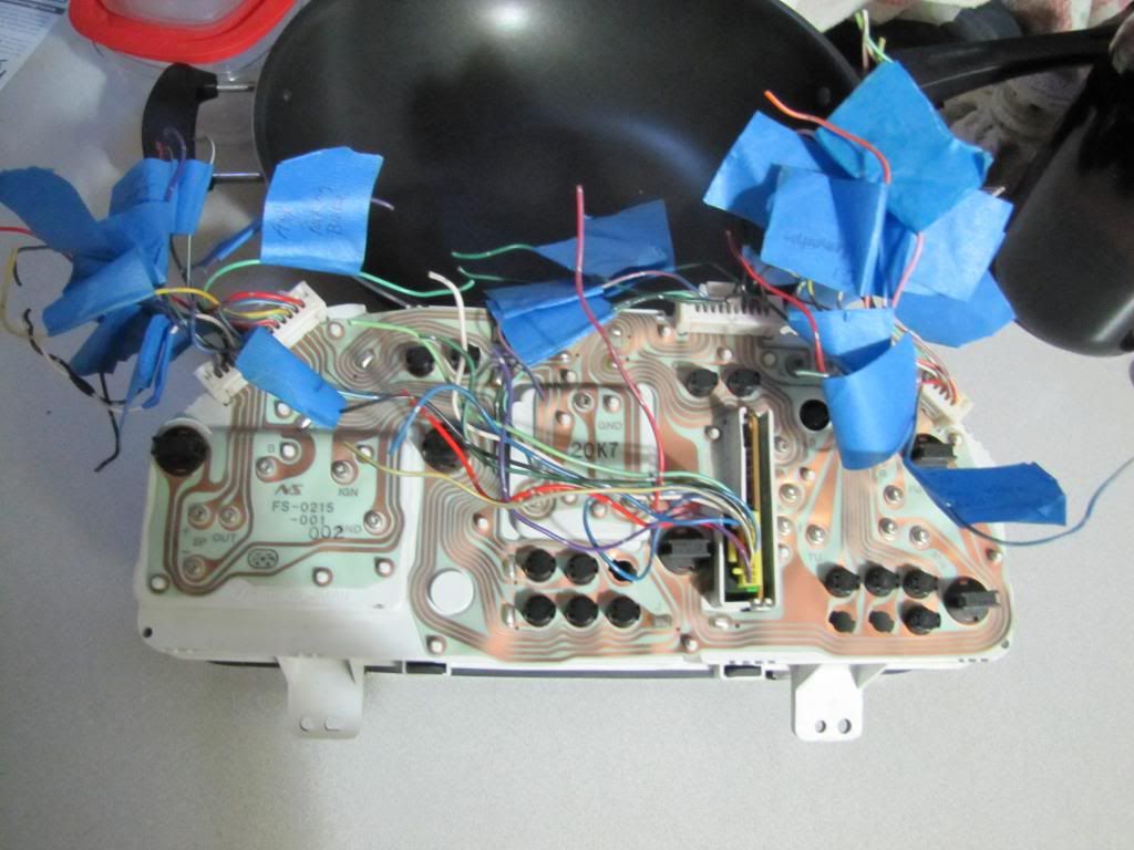

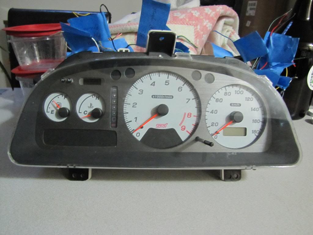

Finally got a mapdccd controller and really want to sport this cluster. PO threw it in with car and doesn't know what it came off. All the info I've found on swaps so far seems to be for the solid circuit board layout clusters, not this flexible type.

Looks like it's a v4 STI cluster w/ DCCD

If you don't feel that adventurous, the V5/6 ones WITH the green plugs pop up on eBay pretty frequently. They plug-n-play if you go that way!

From what little info I have read it seems this guy is almost completely backwards to whats in the stock harness at the moment, wiring wise. Thanks, I'll have to watch ebay!

Your profile said you have a 01rs. That cluster is useless for you.
Thats a version 4 cluster and the only year in the US that fits is the 98. And it requires some re-pinning.
A version 5/6 is a plug and play for all 99-01 impreza(green plugs on top).
Fyi, the clocks buttons on version 4 are H/M while the ver5/6 are -/+
