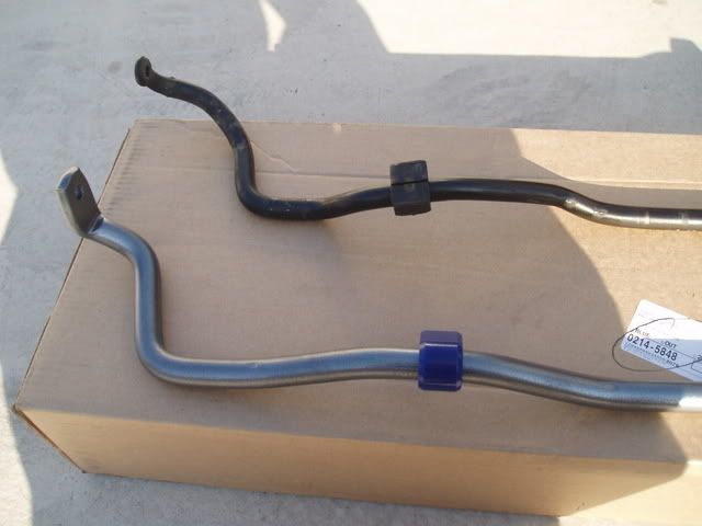

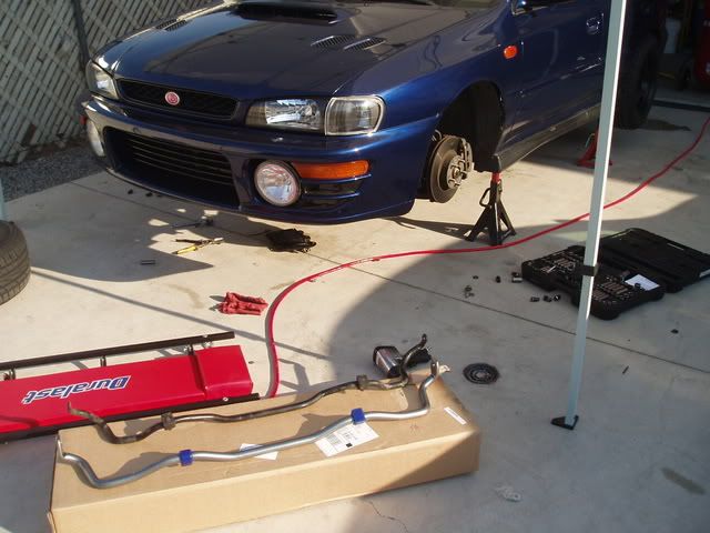

ok so my front sway bar came in today. and i threw that sucker on the improvement it gave my car was noticeable instantly. when cornering it does exactly what I thought it was going to do which is stabilize the front end of the car. I also felt it during freeway driving, call me crazy:screwy: but the lane changes felt smoother and more controlled, I also adjusted my RSB to full stiff (24mm) to compensate for the 22mm up front. I highly recommend this upgrade to anyone that wants to correct the snap over steer that your ubgraded RSB gives you, you will feel more confident cornering and the car will feel one with the earth:rotflmao: but on a serious note its an upgrade id recommend to anyone.
here are some pics from today:

What swaybar is that? And why dont I get snap oversteer with my RSB? :p
it could be your supporting mods, I have over steer because my suspension is pretty stiff, 24mm rear bar W/rear strut bars and 8k/6k coilovers , I learn to feel when my rear brakes loose and on mainly on downhill turns and turns where my cars weight shifts like a winding road (left to right)
What bar did you decide to go with?
I went with the Rallitek 22mm Front sway bar, i like the design and wanted to try a new company out, I'm very happy with the quality in the bar, and they supply you with greese and washer and polyurethane bushings:banana:
