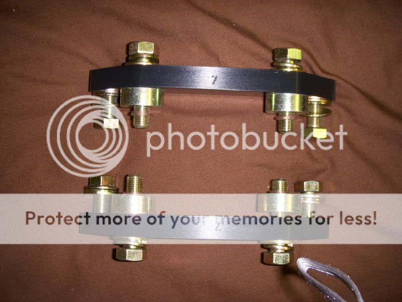

I'm going to be using a Nissan 4/2pot setup and wanted to know if anyone else wanted to do this. If so I was going to try to have the front brackets replicated and offer them to you all. Lemme know what you think. Here are the nasioc threads I got the info from and some pics of the brackets themselves. I'll go get prices and quotes and stuff if I get some good feedback.

Well I got them from a nasioc member who needed to order them so I thought I would get them replicated if people were interested.

All the pertinent information is in those forums. I don't think the 5 spokes will clear if they don't clear subie 4pots. And the rears do sit higher than subie 2pots do but this is mainly for the 4pots. I'm planning on modding some brembo rear pads to cope with some of the "lower" rotor gap, but the top is just going to have to hang over. There are various options on the rotors that can be used with these brackets. You can go as big as subaru brembo rotors or slightly smaller with 05 legacy gt rotors. I'm planning to do this mod in a few weeks whenever all my parts arrive and I'll test them with my 6-spokes. That should let the experience people know what rims will or will not fit.
The main reason I wanted these was the cheaper overall price and the fact that these have bigger rotors. 316mm versus 296mm of the subie 4 pots. Also it's upping in width to with 30mm rotors in the front and rear, subies are 26mm?

Cost for calipers is only like ~$300-400 or less for front and rear calipers. Then it's however much you can find 05' legacy gt front and rear rotors for. I say 05' legacy gt rotors rears because they use the same rear rotor as the 06' wrx which is the one you'd need. You'd also need a 2pot rear bracket, in this case extra work would be needed but you can use the backing plates from the 06' wrx, or use kartboy type brackets. Front pads would be subie 4pot pads and rears would be subie 2pot rear pads.(although they leave a slightly bigger gap at the bottom of the rotors than the subie calipers leave) And I think that would be all the parts you would "need".
That being said if you wanted subie 4/2pot setup it would usually cost more than $300 for calipers.
