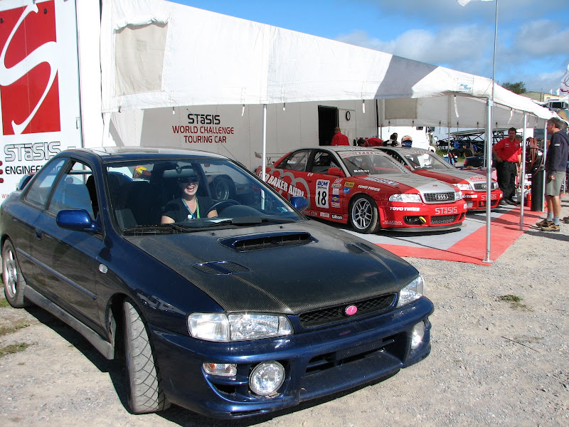

here's where the racing bug all started... World Challenge at Mosport. autocrossing was fun, but i felt like i wanted more like longer runs and higher speeds. and after watching these cars up close, i knew i wanted my own race car, and decided that hillclimbs would be the next step. lucky for me there is the http://www.pahillclimb.org/ and i'm only a hour or so from most of the events.
The Stasis Audi guys were the nicest, they let me park to take the pics and even get in their cars to take pics of me driving them! I asked real time racing to do the same thing, but they were asses, gave me some attitude and said no
