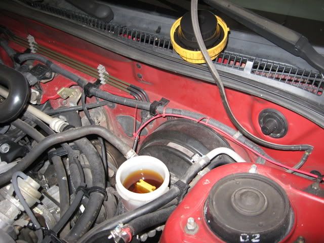

Step 1:

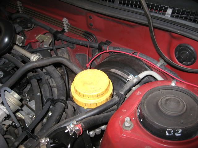

Pop the hood and remove the cap from the brake fluid reservoir. This will relieve the pressure and prevent the Piston in the Caliper from moving when you slide the Caliper out.

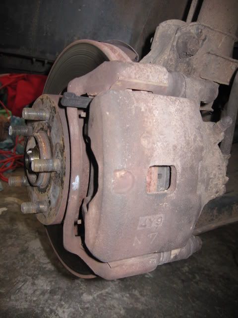

Once you have everything ready to go you need to jack up the car. If it's been awhile since you removed the wheel, before you jack it up, break the lug nuts loose but do not remove them. Once they are loose, use the Floor Jack to jack up one side and support it on a Jack Stand. Go ahead and remove the lug nuts and the wheel and move them aside.
This is what you have:

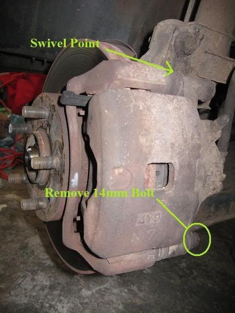

Step 3:

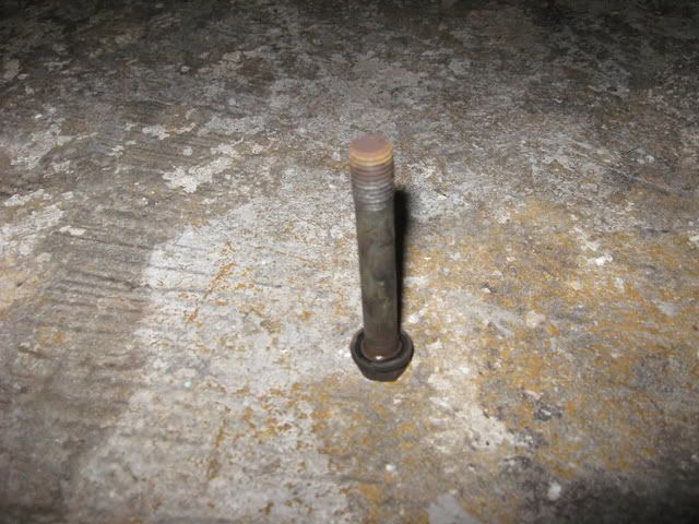

Now you have to take your 14mm wrench or socket and remove the lower 14mm bolt holding the Caliper in place. For this I used a 14mm socket and ratchet because it offered more leverage when breaking it loose.
Here's what the bolt looks like when you take it all the way out. Note: keep the washer in place, you'll need it for installation:
Step 4:

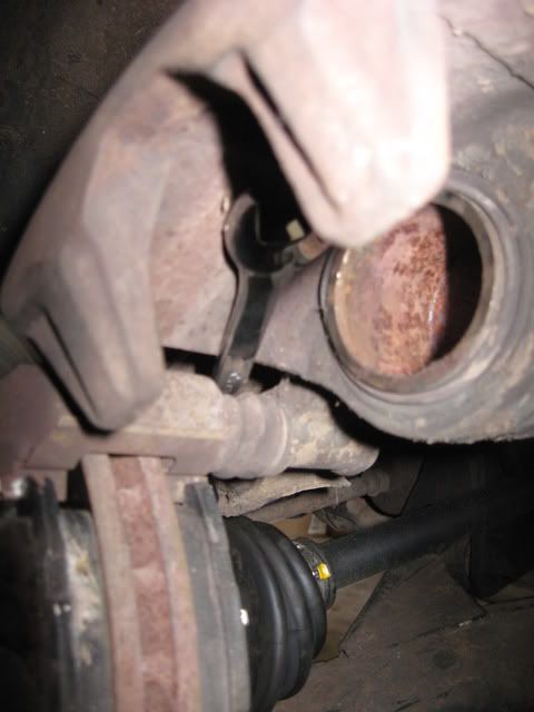

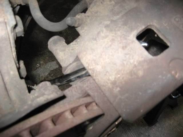

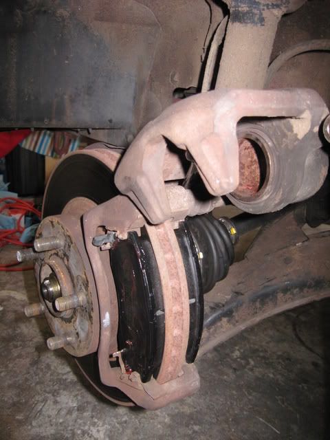

The next step is to slide the Caliper out and up and support it either with Zip Ties or a medium sized wrench. I would recommend Zip Ties, but I only had a wrench lying around:
These are close up images of how I used a wrench, I slid it in the space between the Caliper and the Swivel Point:

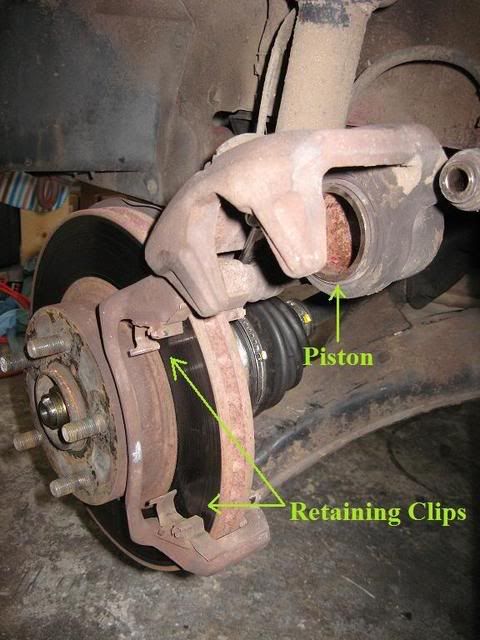

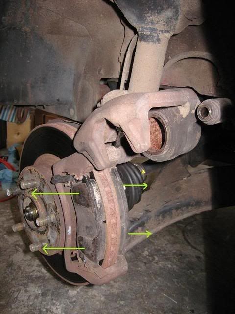

With the Caliper supported, you now have to remove the pads themselves. The trick here is to slide them straight out so you don't end up removing or damaging the Retaining Clips. My '95 is a bit old, some of you may not have to worry so much:
This is what it looks like with the pads removed. Note that the Piston in the Caliper hasn't moved at all, this is why we relieved the pressure by removing the brake fluid reservoir cap in Step 1:

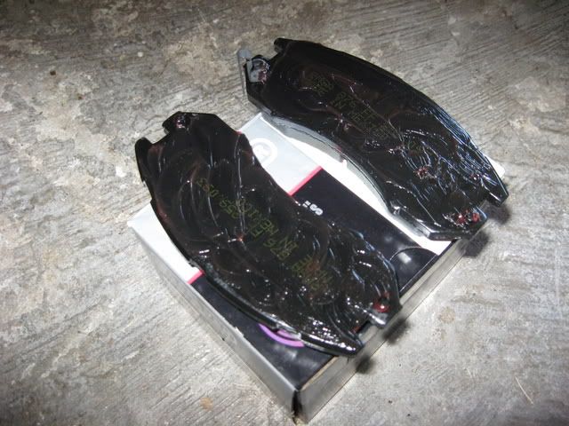

For Pad Installation you need a few things. One, the Pads. I bought OEM replacement pads from Autozone:
Two, you need either a Multi-Purpose Greaser, or Brake Pad Anti-Sqeek Grease, I just used Multi-Purpose Greaser, it works the same to prevent squeeking:
Now you have to properly grease the backside of the pads, the side that comes into contact with the Caliper and Piston, do not grease the side that makes contact with the Rotor:

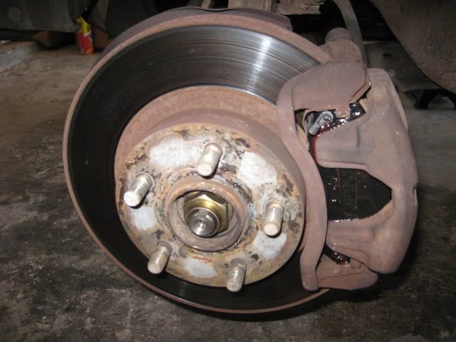

Now you have to slide the Caliper back down and slide the 14mm bolt back into place and tighten it down. For this, it's easy if you slide the Caliper down and apply pressure to the bolt while sliding the Caliper back and forth until you find the thread. Screw in, tighten down:

Now go ahead and put the brake fluid reservoir cap back on:
This is VERY important. You have to pump your brakes to initate pressure back into the system. When you first do it, you'll start to feel pressure back into the pedal. Do not drive the car until you do this parked.
