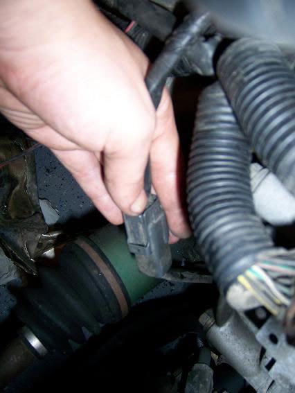

Now its time to crawl under the car
Remove the Second Fan Plug: This is for the drivers side fan
http://i175.photobucket.com/albums/w129/scoobysnack_photo/engine_removal/EngineRemoval-017.jpg

how do you manage to operate a camera with dirty hands? one of the reasons i never take pictures while working on my car
I put a rubber glove on :lol: Just one of those cheep doctors rubber gloves.
