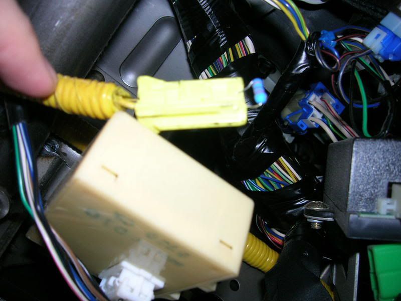

I get questions often, here is is:
:blowingup:blowingup:blowingup:blowingup:blowingup:blowingup:blowingup:blowingup:blowingup:blowingup:blowingup:blowingup:blowingup
I'm Certified in I-CAR Advanced Restraints, so listen up.
an airbag can kill you.
ANY YELLOW WRAPPED WIRE OR YELLOW CLIPPED HARNESS OR YELLOW STICKERED SENSOR IS USUALLY AN AIRBAG SYSTEM
do not attempt to modify any airbag, or airbag stystem
always disconnect the battery while servicing an airbag.
try to stay grounded to the car, and avoid any static charge buildup while servicing an aibag
do not swap, or install an airbag that is not specifically made for the exact car you're dealing with..
do not tolerate an airbag light in your car, you may not care about your own life, but your passengers children may when she's dead - get it checked out.
unless your car is set up for full race and helmet... you want your airbag system in full working order.
other than the obvious death by, or death from non-function, there is also a huge liability of being sued by someone who drives, is a passenger, or even steals your car, i'd imagine.
some shops even have an outsourced airbag dude who comes in for the actual install to skirt the liability of this practice
airbags are specifiacally tuned for each vehicle taking into account the seat position, and geometry of that specific car...
most modern cars also have seatbelt pre-tensioners linked to the airbag system, these are like a shotgun charge in your seatbelt that grab you back in your seat upon impact..
airbag systems deploy in various degrees depending on how hard the impact is, so keeping all the systems functioning is pretty vital
some luxury cars actually use sensors to see your weight and head position using a small radar sensor in the A-pillar
all airbags are timed so that a perfect deployment does it's job.
any imperfect deployment could be fatal
