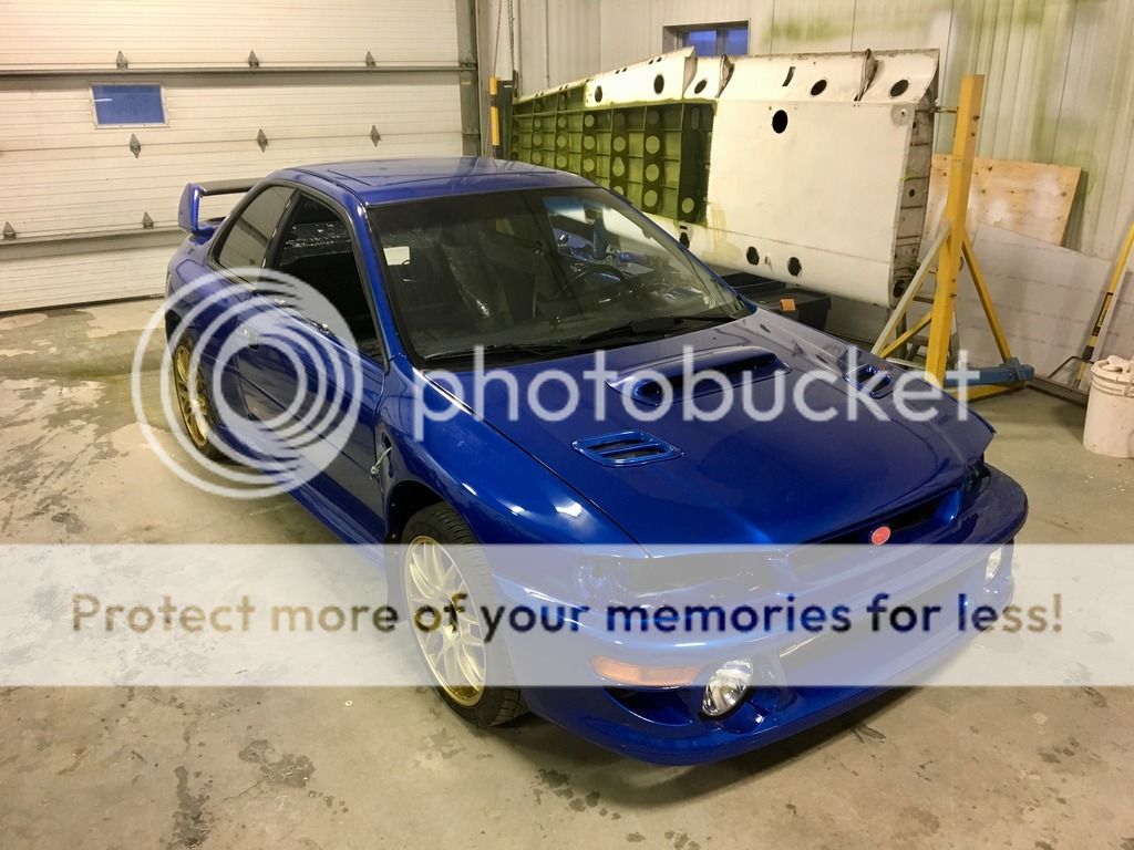

This update is way overdue. Just like everything else right now.
I moved the car out of the rented shop at the end of April. All the painting was done, new windshield installed, as well as the engine.
Header wrapped and installed.
I had a pro come install the tint on the rear glass. For what it costs It’s totally worth it.
The 3” STI SS exhaust I bought was for factory fitment, however the NA intake and fuel rails were tKing all that real estate in front of the turbo. So I was forced to buy a WRX intake manifold and then retrofit my NA harness and TB onto it. Using the WRX harness that came with the manifold was just not something I wanted to do. So I hope there’s no boost leaks out of this when it’s all bolted up. I made a custom adapter plate out of 1/16 aluminum sandwiched between the intake and TB.
It was a rats nest of wires in the pass footwell before. I took the factory ecu out of the case and repurposed the case to hold the Emtrons ecu. Then tucked all the wires under the kick plate and run the comm cable into the glove box so whenever there is tuning to be done just open the glove box and plug in the laptop.
No room behind the turbo for the Cruise control unit I snagged at the junkyard so it’s going in the passenger fender behind the ABS unit. Extended the wire harness and it should work good. All I need to do is figure a way to mount the wheel controls in the column somewhere and find the correct wires.
Fenders and liners are mounted. Paint still needs wet sanding and polish.
