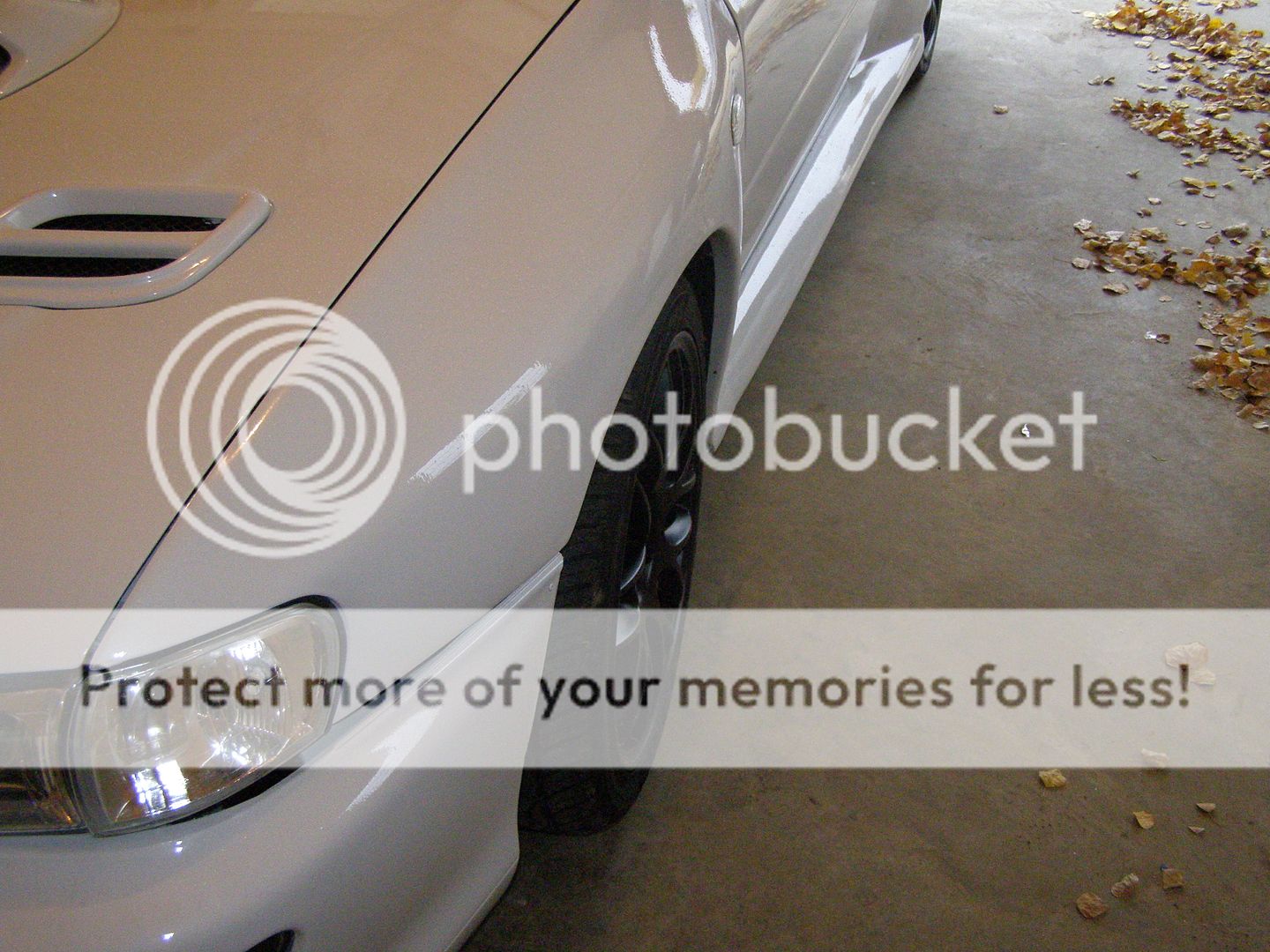

Put the summer rims back on yesterday along with the 22B emblem. I was debating putting the emblem on or holding onto it in case I decide on a later professional RBP paint job but I found another one in case. The rears are as flushed out as they will probably ever be but they have a nice stock look. I love the goldies on a stock GC but they look tiny in the big WRC wheel wells and sit too far in because of the smaller width. So they have some studded ice tires on them for winter driving. I was gonna wait for the engine to be done to swap them but I couldnt wait anymore and it will save some time after the engine goes in. rotten pics, Im so tired of having it sit in my garage for so long but nothing else I can do but wait.
also gave it a little wash to take all the garage dust off it
