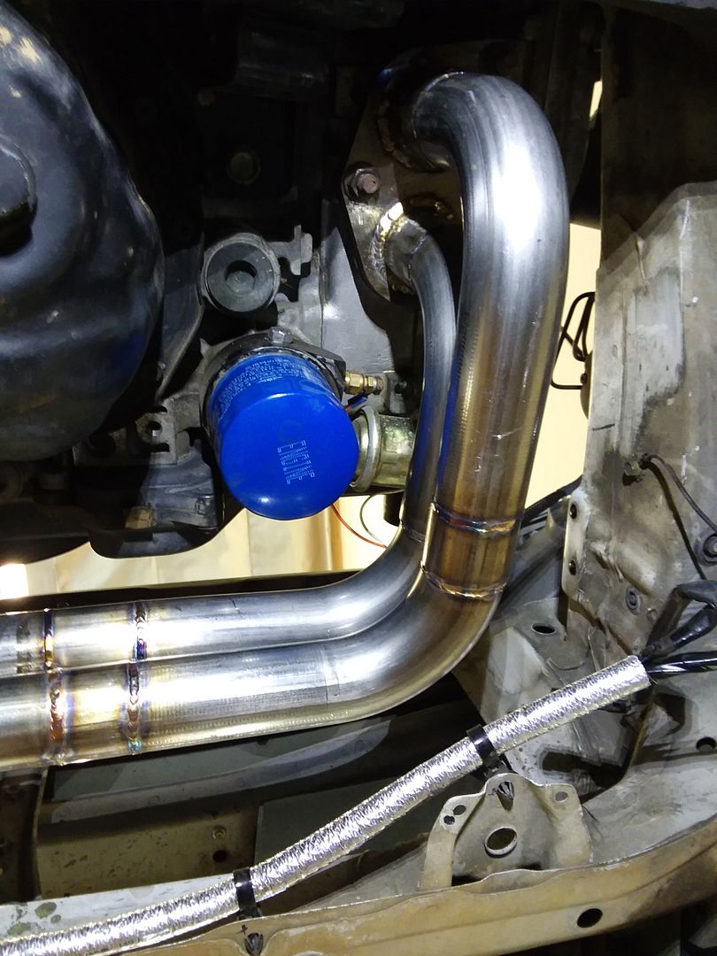

Leading up to the event I found a small coolant leak, which turned out to be from the water pump. So took care of new water pump and timing belt. Also had time after the Laguna Seca event to install the intake and headers, and get the Hoosiers mounted on an extra set of RPF1's. Almost forgot to switch out the race pads for autocross pads, so got that done the day before but got too lazy to bleed the lines.
New headers have much better clearance around the oil filter. Very high quality work by Inferno Fab, and better sound than the Borla.

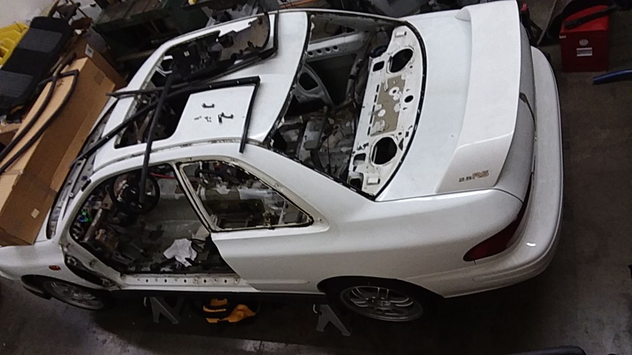

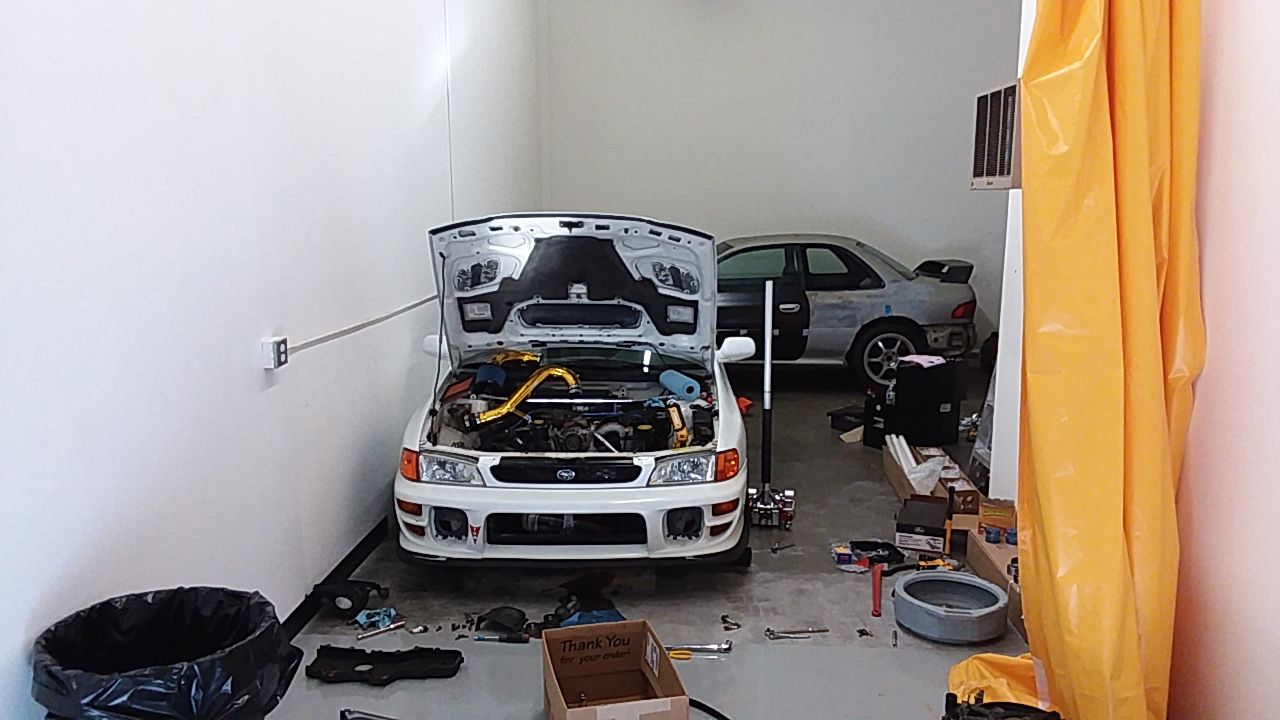

Slow going on this! Between enjoying my other cars, raising two little kids, and getting the RSTI to the paint shop for new bodywork and a full color change, so little time for the track car.
Current state, which needs to change ASAP by the time Subiefest comes around. Original dash and doors not going back on, along with some other goodies if time allows...

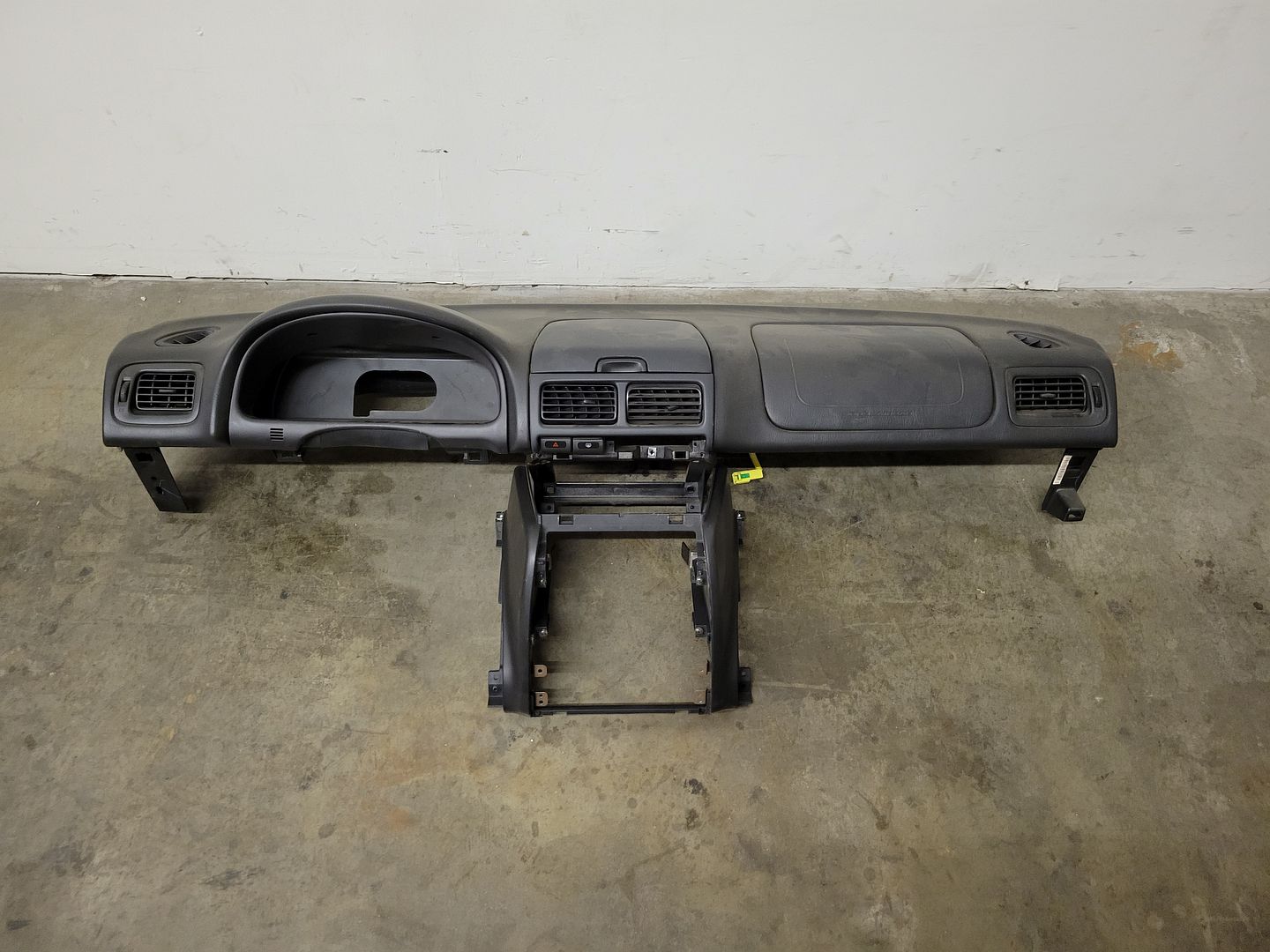

Too many parts laying around that are no longer needed and going to post them up for sale.
If anyone needs a '99 2.5RS dash, sunroof assembly, or other interior parts in the LA area let me know. Stock hood available soon too.

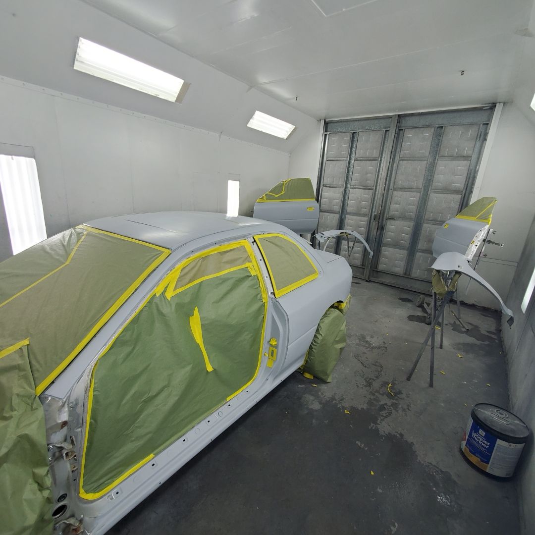

Still very little progress on the track car and running out of time!
Some of the attention has been on the RSTI, and maybe it needs its own build thread.
Nardo Grey complete repaint coming along by the body shop:
Base coat, still needs clear. Will be a lot of work to put it back together flawlessly!

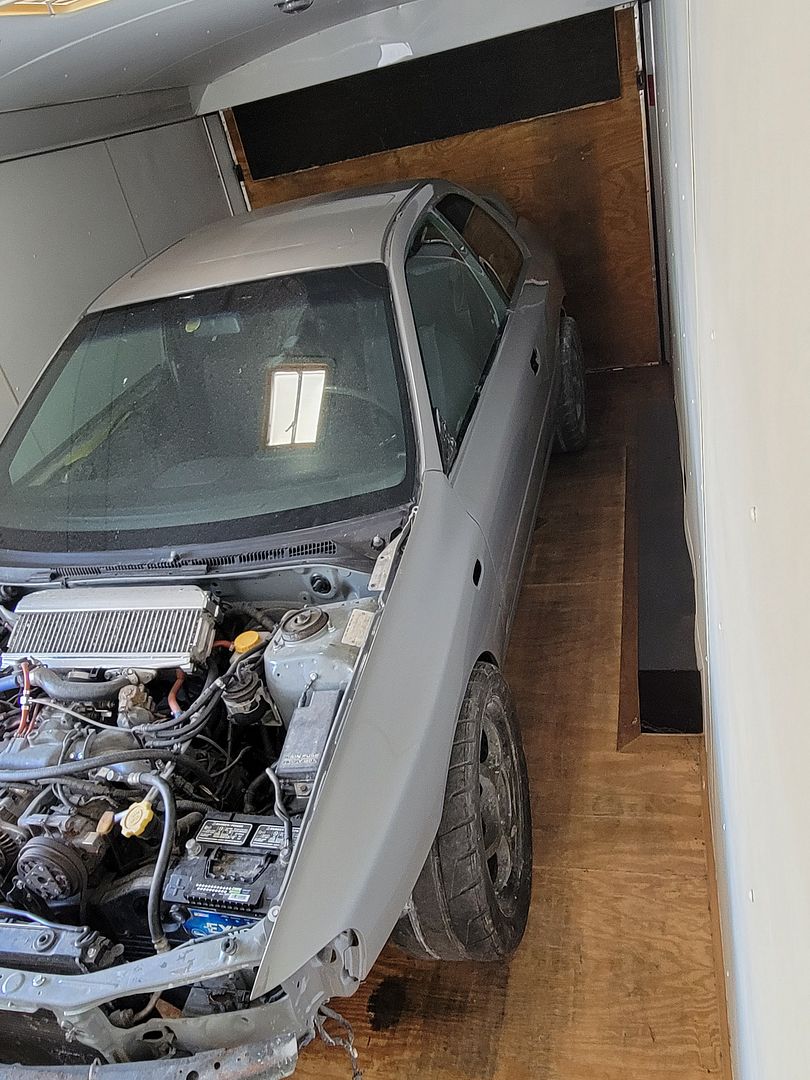

Might have to update the title after this! Engine build plans are being finalized with Tom at TWE for a naturally aspirated motor build with a goal of 240awhp+. :) 12:1 compression, 9,000 rpms, and more.
Still a few months before engine can be shipped and installed, but aiming to try it out at Laguna Seca in '22.
For now, added an enclosed trailer to the mix. Will build it out with tool storage and pit equipment. So much better than using an open trailer!

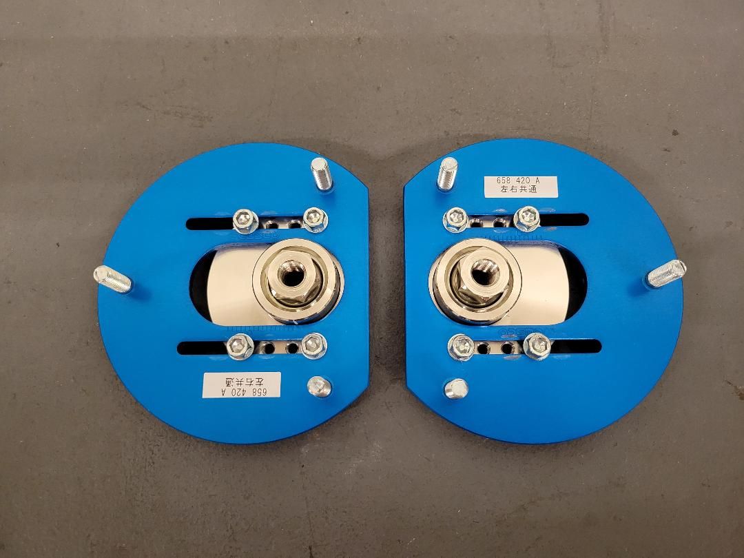

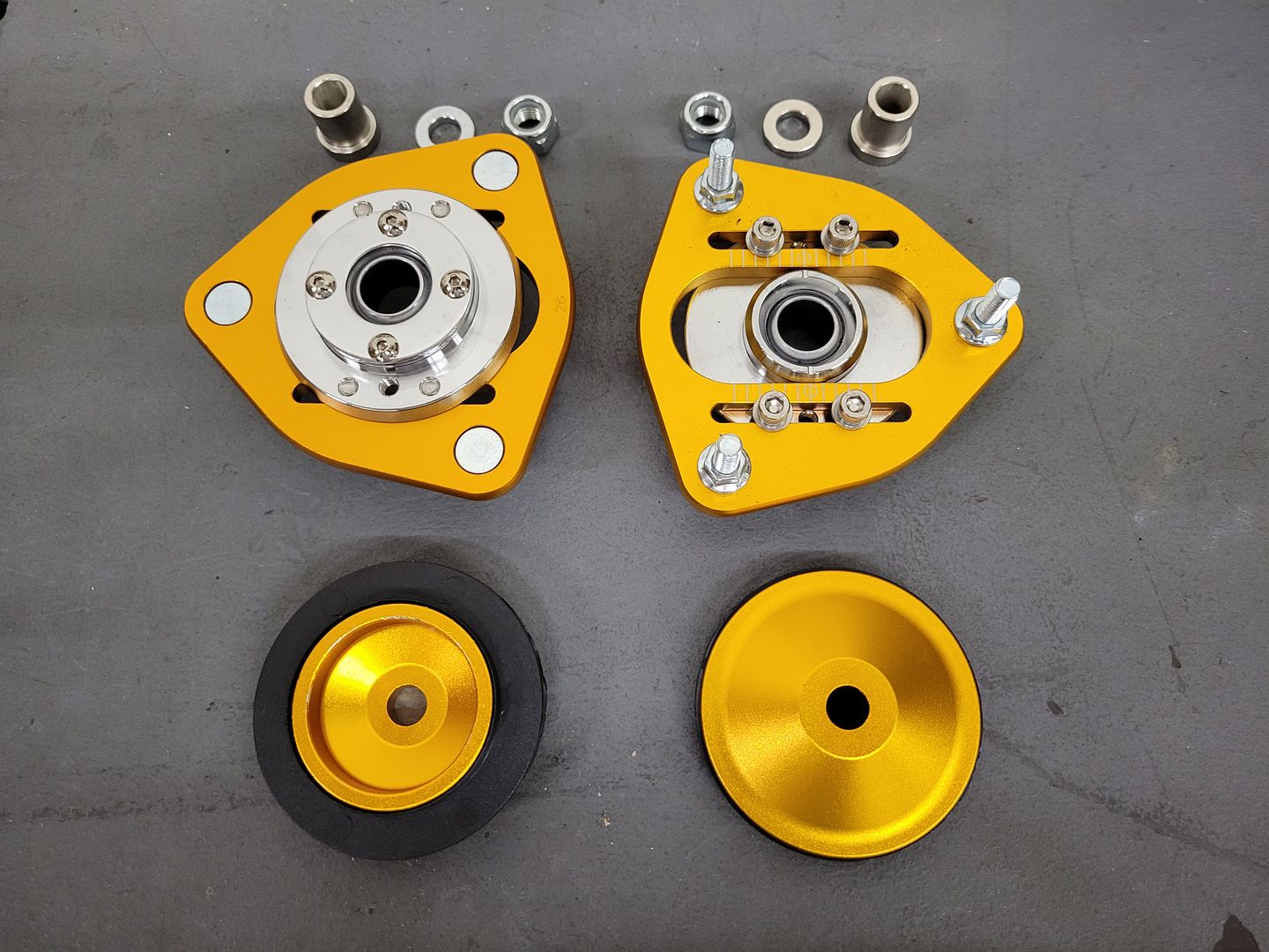

Went to install Cusco rear camber plates this morning, only to discover they don't match the bolt pattern of the rear shock towers! Not sure why I bought these a couple of years ago thinking they would fit. ISC camber plates have now been ordered.
Really need to correct the camber curve on the rear, as the camber goes positive with a little body roll and it's not ideal for outside tire grip.
Was ready to machine new spring top mounts to fit under the camber plates because the Teins have squishy bushings attaching the damper to the top mount and a thick rubber washer between the spring and upper perch. Terrible for precision damping control with the rubber doing most of the work on initial bump and rebound.

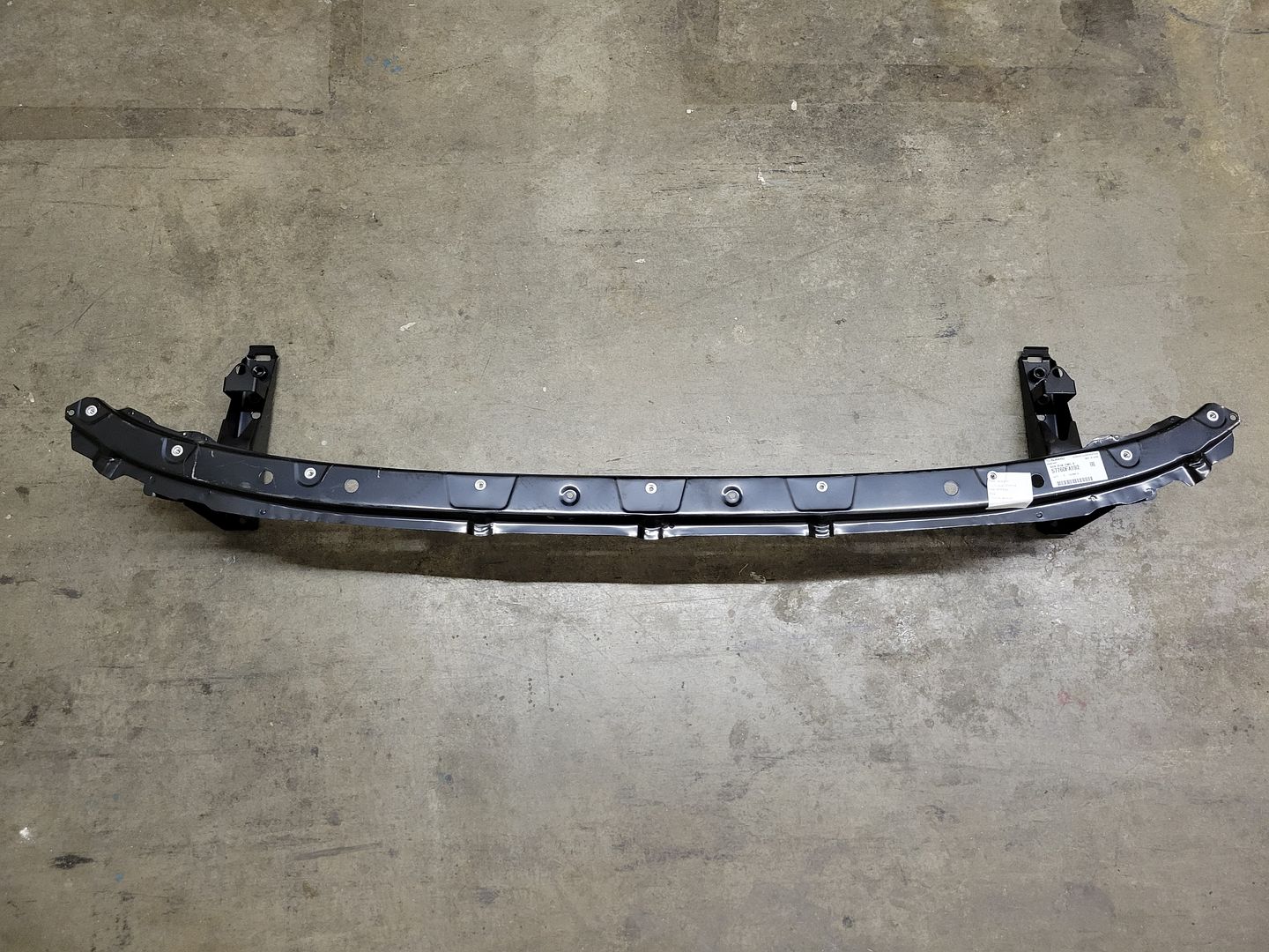

Also finally replaced OEM heavy bumper beams with brand new JDM lightweight versions I've had in boxes for years. Installed aluminum threaded inserts in place of all plastic clip mounts. I do this on as many locations as possible to avoid having to deal with plastic fasteners again.
USDM front beam- 36lbs
JDM front beam- 7.6 lbs
USDM rear beam- 30.6 lbs
JDM rear beam- 4.7 lbs
53 easy pounds removed! And from the ends of the car where they most affect steering response.

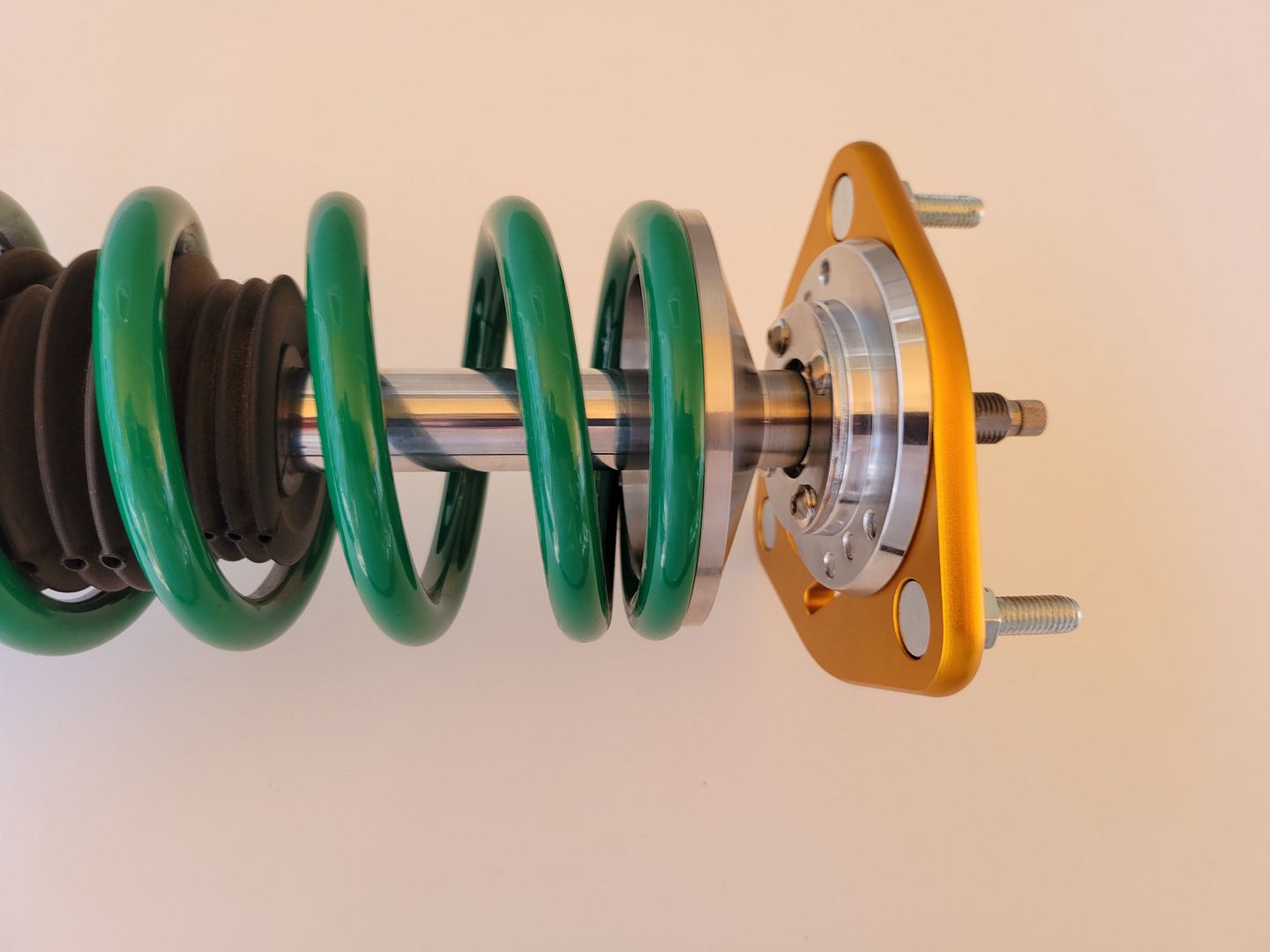

Realized a week ago that the Cusco camber plates don't fit, so ISC rear camber plates were ordered and have now arrived.
They match up to the shock towers, but now the upper spring mounts don't work with the Tein suspension! ISC mounts are for 2.5" ID springs, and the Teins are 2.75". So I'll be machining stainless steel upper spring mounts.
See less See more

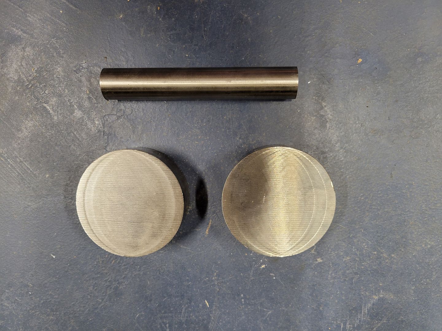

A little bit of machining over the weekend. Made stainless steel upper spring mounts and spacers to fit under the rear ISC camber plates and into the spherical bearing.
Starting with this:
Some lathe work to produce the bumpstop surface and seat for the spring top:
Taper on top to make it look nicer and shave some weight:
Finished parts. A little heavier than I would like, but much stronger than aluminum and will not corrode

Now the ISC rear camber plates work with the Tein coilovers!
Assembled and ready to add some rear camber for better contact patch. There is now zero rubber in the rear coilover to improve precision versus the original rubber spring seat and rubber bushings holding the damper shaft to the original upper mount.
