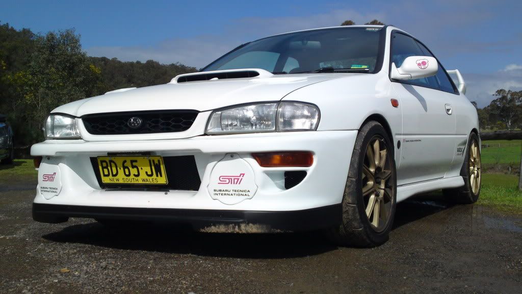

Thought l would start this build up thread seeing the car is in the workshop and should be complete within the next couple of weeks
l bought my Aus delivered Version 5 STi back in late 2005 for 31k, it had 40,000 kms on the clock, 1 owner in his 50's, and no accident damage. It was the perfect platform to begin modding.
After a few years of hard driving and training days the 8 year old components started showing there age, so l decided to do a complete drivetrain swap from a later model car
last year l came across a complete drivetrain from a 2006 Spec C Type RA , so l snapped it up and have been planning the build ever since
l finally have everything l need for the swap, car is down with Ben from Tougetune who will be doing the conversion
so what happens when you take this:
and put it in this:
Here is the Mod List off the top of my head:
(l'm sure there is alot more l have forgotten)
