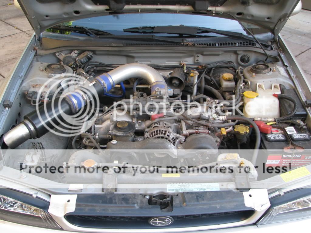

I have a 06 wrx swap and im loving it low end torque is bliss man. Its stock so once i get a tbe, turbo upgrade and a tune ill be mashing on sti's =D
