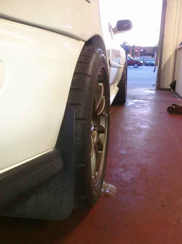

Originally Posted by jdmflcl View Post
Looking good! Lower it
In its current state...it's actually a tad higher. I plan on lowering it a little from where it is now, but i don't think it'll get any lower than that.
Instagram - MrIndianSteve Check out my stuff for sale!
Indian Steve is offline   Reply With Quote

Originally Posted by Kowitz View Post
At least a little more negative camber!
I can't say i am a big fan of camber, i will probably run a little bit more but until it is a track car only and not my DD...i don't feel like going through the 275's!

did the 22b rear fenders come with a gas cap door?and is the cap like sunken in?super minty car by the way lol
It didn't come with a gas cap, i used the stock one. It is sunk in a bit...you just have to reach to put gas in now. And Thanks!
