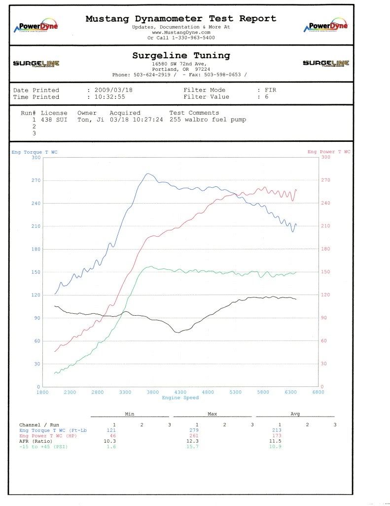

I dyno'd the car at Surgeline Tuning in Portland, OR days after picking it up . Tim and his staff are great. My car dyno'd at 261hp and 279ft/lbs. Good numbers, but the motor is destined for more!

*Updated Dec 2010
Modifications
Engine:
EJ22T
Stroked to 2.4
Wiseco Stroker Pistons
48mm Chromoly H Beam Rods
EJ25 Phase I Crank
ACL Bearings
USDM Turbo Legacy;
ECU/harness
Intake Manifold
EJ20G DOHC Heads
JDM Legacy RS & GT (turbo) Transmission MY97-98 TY752VBCBA 4.11
440cc injectors
Walbro 255
VF-39 on 15psi
SS Autochrome FMIC
HKS SSQV III
K/N Cone Filter
HKS turbo timer
HKS Fuel Cut Defender
SpeedTech Catless Bellmouth DP
Invidia N1 Cat-back Exhaust w/ resonated midpipe
