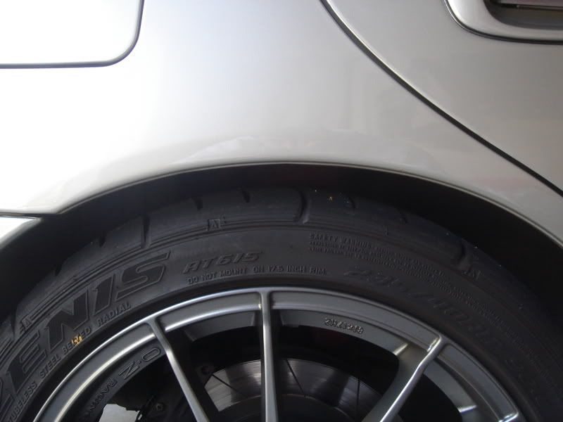

I have 17x8 +48 and 235s but I dont know if they are an aggresive wheel fitment compared to some of these. Ill take it down if its not aggresive enough.
Wheels: 17x8 +48 OZ Ultraleggeras
Tires: 235/40/17 Falken Azenis RT-615s
Camber settings: -0.25F, -1.1R, 0 toe all around (stock settings )
Suspension: KYB AGX w/ 5Zigen springs and washers in rear to elimnate ass sag (switching to SPTs, see below)
Rubbing: Im riding on full stiff (4/8) and I get a little rubbing on hard bumps in front (chewed up a little fenderlining), rears seem to get a very tiny bit on high speed bumps while cornering like exit ramps and such.
Fender Rolling: Fronts are stock and rears are cut/rolled
Notes: Switching to SPT springs to keep higher spring rate and increase ride height to eliminate some rubbing especially on the fronts so I can soften the dampening on my AGXs.
