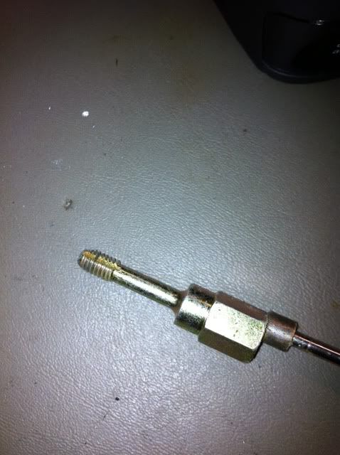

The Second Dilemma: The Balljoint
As you can see in the picture above, the front knuckle has the balljoint fastened inverted where the cup is pinched into the knuckle. While it was already impossible to remove the bolt that held it in place... it was even MORE of a chore to determine how to remove the balljoint from the knuckle...
There was no thread online with a definitive solution to removing the balljoints. Others didn't seem to have as much trouble as I did... so I made a tool...
AND IT WORKED!
New vs old

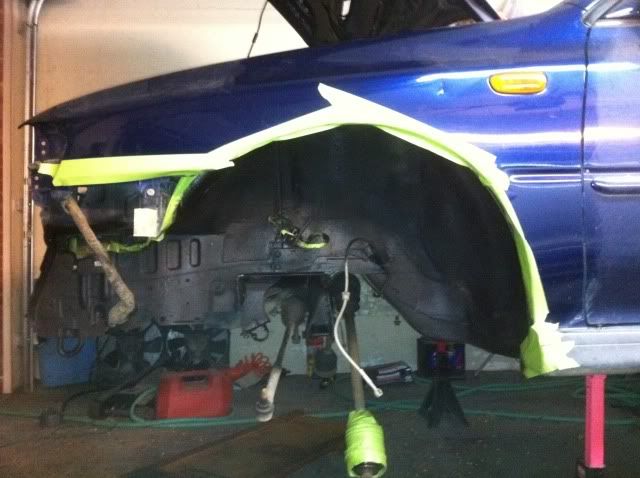

The Work:
-All threads on the frame were chased with thread chasers and filled with anti-seize
-All components were torqued to OEM FSM specs and ADJUSTED for anti-seize with a NEW, broken-in torque wrench (no calibration guessing) with Crow's feet where applicable.
ALL ... and I mean ALL surface rust... on interior metal pieces, harness bar, rack, underside.. was taken to with a wire wheel and spray painted high temp non-gloss silver (not pictured)
Bench setup:
OFFset bushings had to be pressed in, in the right direction to give the car more CASTER (went and bought a shop press)
New Whiteline bushings ALL AROUND THE CAR... Because Race Car! and Bushings and shit!
Before and After shots of suspension
Got to the underside with some undercoat. TIP: DO NOT BUY CHEAP SHIT. BUY 3M. STUFF WILL NEVER EVER DRY EVEN AFTER MONTHS!
