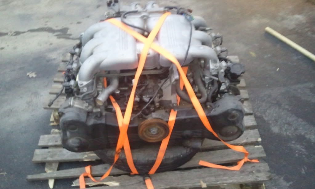

Pictures of the EG awaiting installation.
Going to pull and paint the intake after a good degreaser bath and steam cleaning. Thing is going to be clean enough to eat off of .
