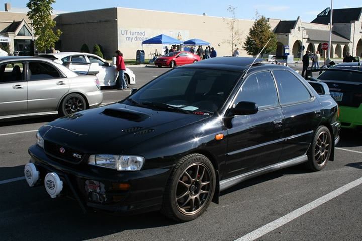

hey guys time for my next journal! i used this for myself as a list of stuff i wanted to get done, and since in my searching i didnt see anyone doing specifically what i'm doing i may have a lot of questions along the way.
its going to be short and hard to read but i'll fix it here when i get things moving.
so starting off, i was on my way to PA to check out a 00 stm sedan rs. no body rust, well he sent me pics of the underneath and i gagged. fithy, well we headed up there to check it out anyway. we're rollin down some back woods hill billy town we pass used car dealer, my gf (savior of the year) spotted a black gc! (not really lookin for a coupe) so we turn around. dude! its a sedan, had rusty quarters, they were fixed and primer'd over, i took out the trunk panels and they cut out and fiberglassed in. the rust was only about 2" long and 1" tall i look underneath, its amazing, its almost as clean as my north carolina coupe i just sold! i'm thinking he wants a small mint for this car, asked him how much. half the price of the one i origionally was gonna get. i was sold.

how she sat at the dealer guy's place
loaded it up headed home:
driving, i think i'm missing something?
engine is in!!!!!!!!
Most Recent pic
