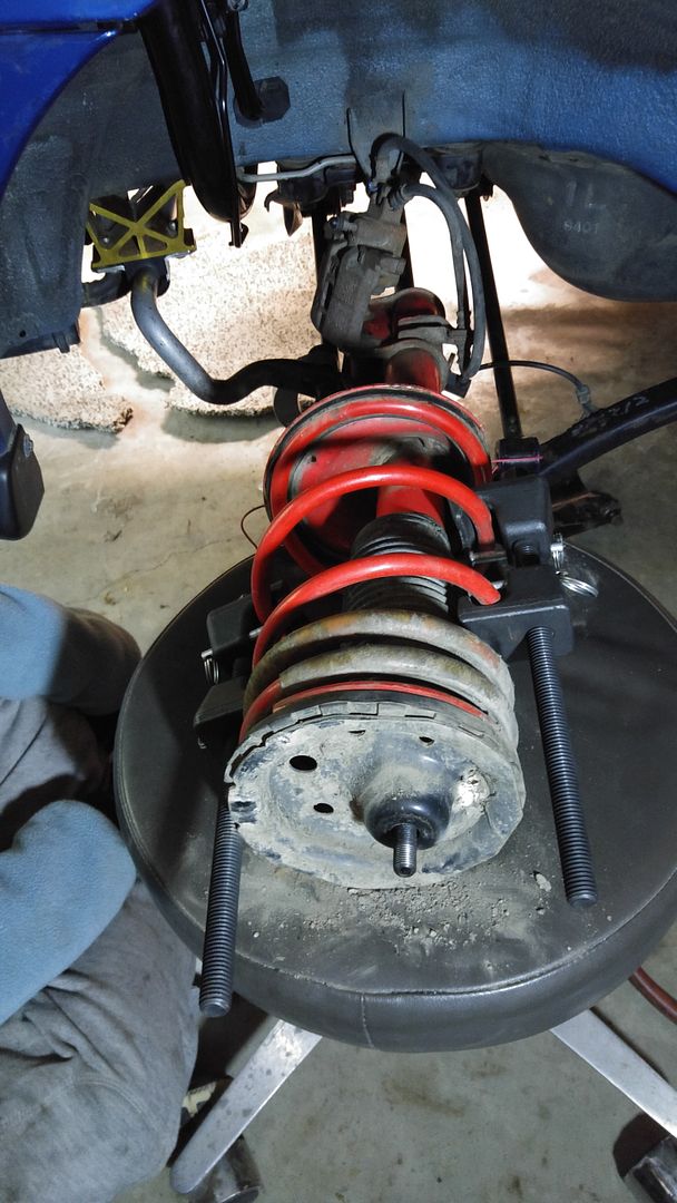

Took a break to charge the time lapse cams, eat some dinner and pick up a spring compressor
No strap wrench so I'll wait to get the hub/wheel on the ground to torque to spec

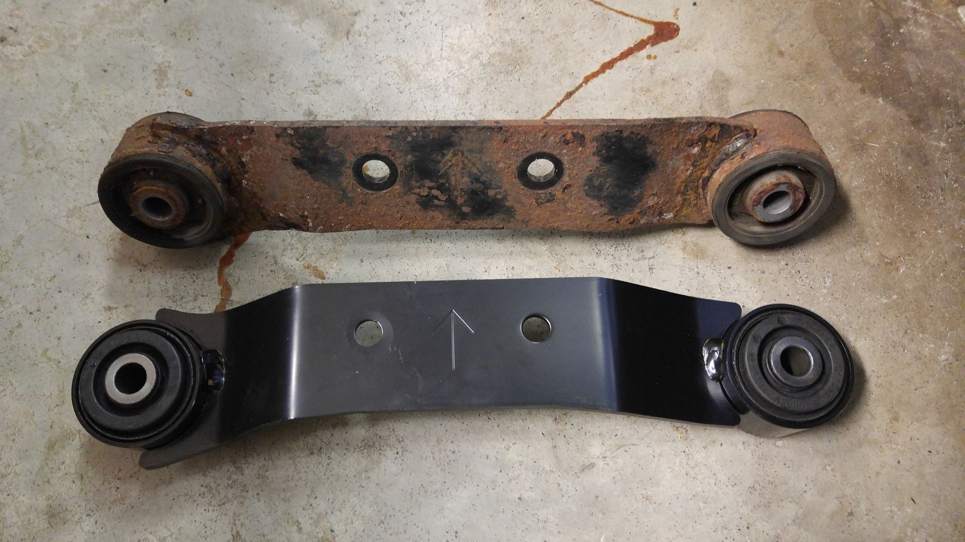

First thing on the list was getting the rear diff mounts mocked up. Old vs new groupN diff bar

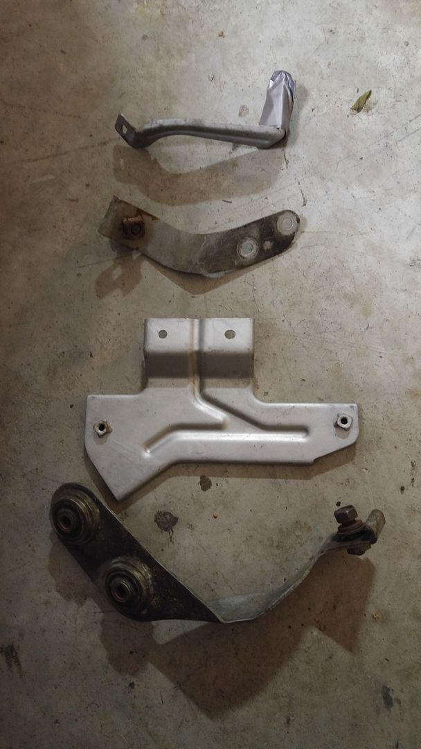

Sorted some parts and called it quits for the night. Decided I need to do a bit more research to find these dudes proper place
1. Ground cable bracket(i think). Had one on my harness already so I'm thinking this one is from the donor.
2. WRX downpipe J hanger
3. Still working on this one
4. RS exhaust J hanger.
Sunday started off by installing the brackets I figured out. Got the wrx downpipe j hanger installed and realized the other loose bolt on the side of my trans was for the stock downpipe's second mounting point. Then took a run to oriely's to return my spring compressor and order my ebrake setups

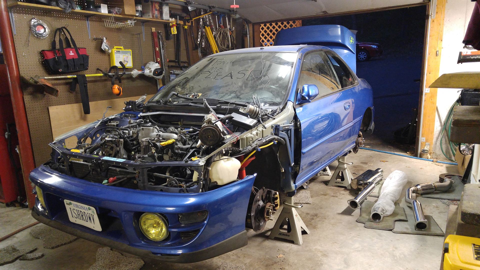

Friday I started in on the engine/components. Began working on the driver's side and made a little headway. Wiring was sorted a bit better, alternator and A/C have been bolted down and compressor lines massaged to fit.
Saturday I started off by installing the filler neck lines I picked up. Still need nuts for the roll over valve and hardare for the plastic cover
Then moved in on the engine bay again, Swapped over my fuel lines and jegs inline filter
Modified the wrx boost control solenoid bracket to fit the rs bay. Just need to get some of those nifty threaded rivets so I can bolt the middle mount down and get it nice and solid. Also gave me the spot for some plugs to be clipped.
Finished routing my heater core lines and compressor lines
Before bolting the power steering pump down I needed to knock the inlet off the ToDo list.. Knew it was going to be a wrestle, but got the old out and new in. My valve cover breather line wasn't cooperating, with or without the 1" snipped off as instructed I wasn't able to route the line successfully. Also the smaller 2 vac lines were old and splitting so I'm going to replace those before finishing the install.
Called it quits for the night.. Missed tool time sunday for a friends bday. Here I sit on my Monday lunch hour and I'm dying to get back at it!

Finally spurred myself to get out there after work last night. Finished the inlet install, a couple other vac lines were falling apart on me as I was persuading everything into place so swapped them out with some extra new lines I picked up. I'm going to get an AOS setup asap and plan to replace all the lines with a quality set once she has a clean bill of health. So this is more or less a band-aid until then
After the inlet was finished I massaged the power steering pump into place, drilled out and mounted my reservoir. Then mocked up my coolant expansion tank and intake. Looking great and everything is starting to fit up!!
