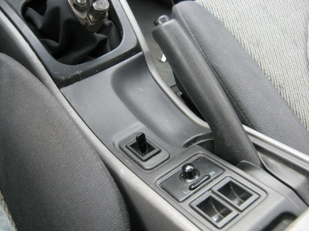

I also re-mounted my auxiliary light switch. Since I removed my old Hella wires and switch, I needed another switch plate to hold my one remaining switch. I just modified one of the blank switch covers:
