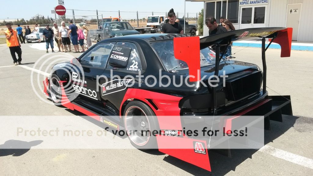

Civic won time attack event in my class... beating M3 CSL, quick Evo 6 and Turbo S2000...
Claimed to have 208 h.p. and no window wipers ))) Need to learn Greek to read those damn regulations... Someday...

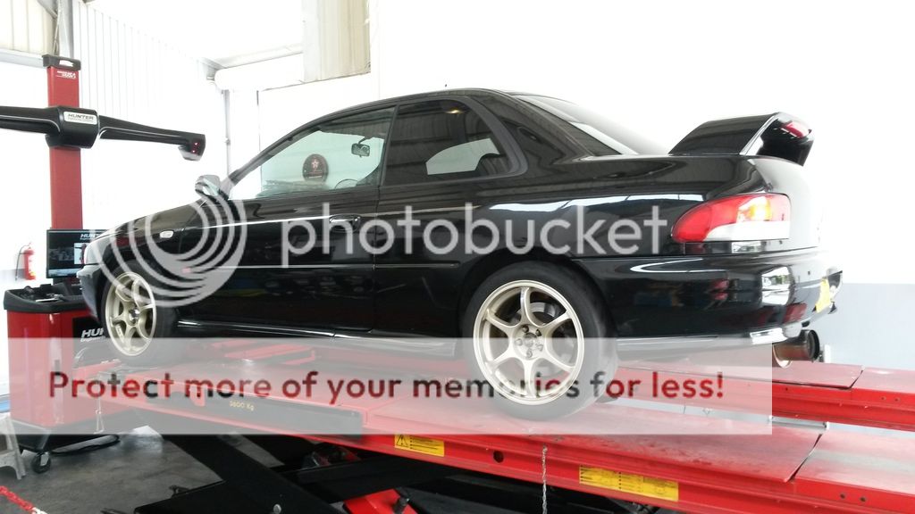

Car is still in pieces so, for this occasion I got Type-R out of garage, put Dunlop semis on and took her for the alighment.
On stock ride height and semis for me car looks strangely appealing

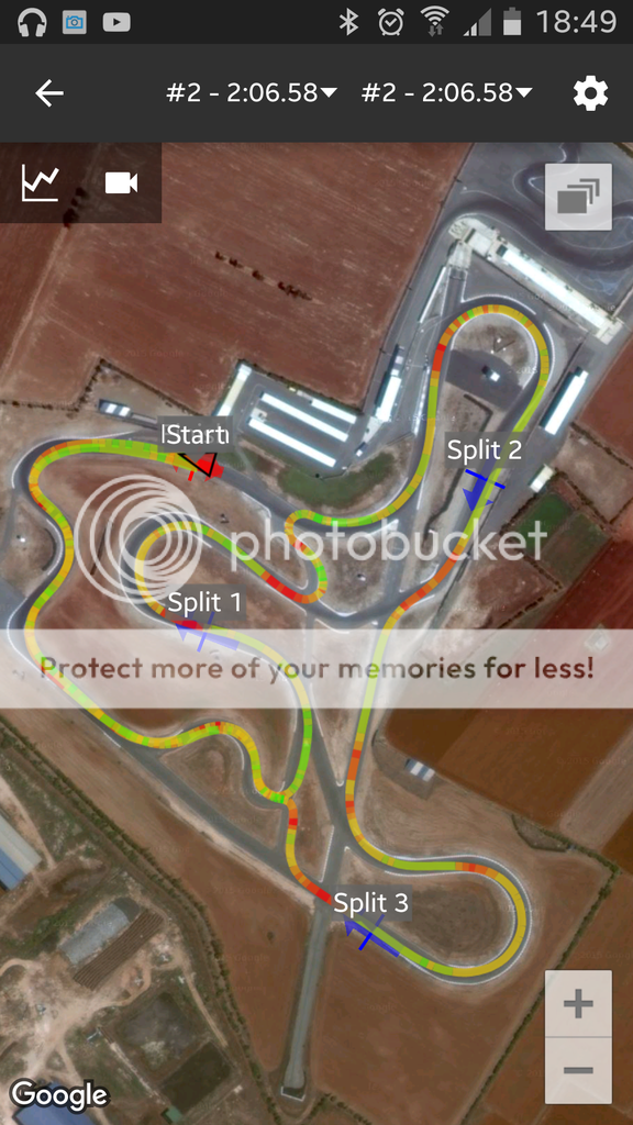

here is the video of best time, later I will do data overlay for second run with time gap to see the mistakes. I did datalogs on everything that I could
I was really happy, mostly because no matter how I tried to screw things up, Type-R managed to save it's reputation and remain victorious One guy did 2:06.xx, but he smashed the cone and they cost +3 sec each.
