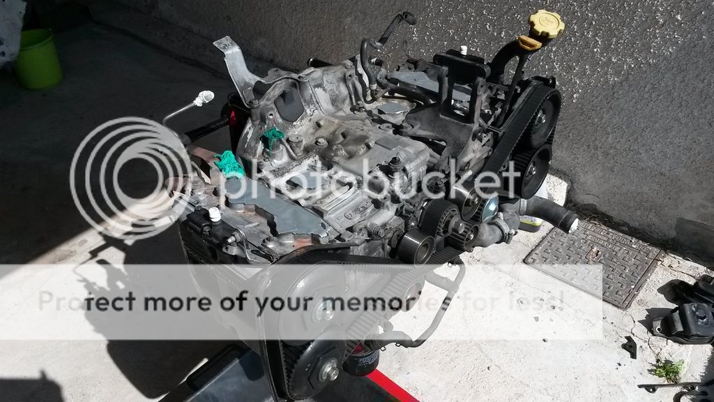

This weekend I worked on engine to prepare order for engine parts.
Engine suffered from a old power steering fluid leak, so I decided to clean it and probably reallocate PS tank somewhere. Or at least replace some seals to stop the leakÖ
Also crankcase vent hoses become hard as plastic and all connections were leaky and dirty.
Before:
As the result I washed it three or four times every time removing more and more bits that were not allowing to clean it better.. Many cans of engine cleaner later, kind of semi-finished result:
later I removed timing bits and coolant tubes over cyl 2 ad 4 and cleaned it once again

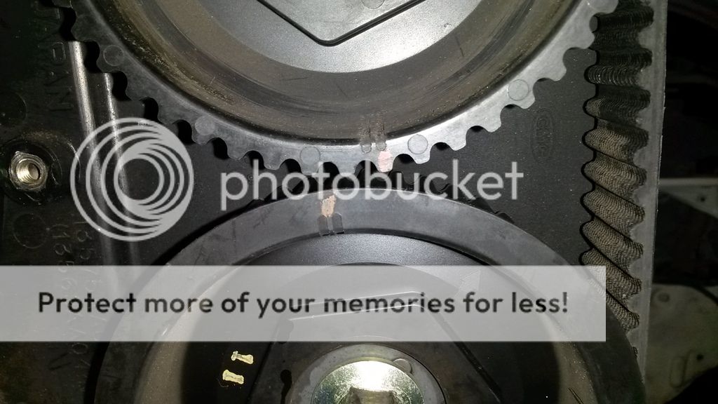

Timing belt was off on all cams except for RH intake (1 and 3). Hereís pic of LH cams with crank marks alligned:
I wonder if this could be a cause of poor performance comparing to my other car.
most of the pulleys are toast, so gonna replace them and timing belt

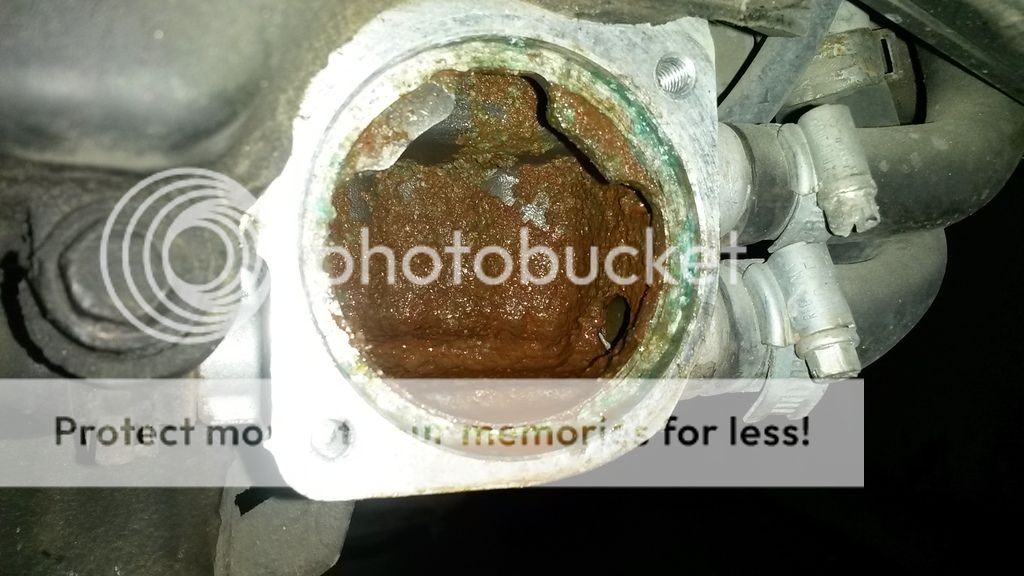

Water pumpÖ Probably good idea to replace it because that looks scary:
Any idea is there a way to clean the block inside? I rinsed it with water, but maybe thereís some trick or solution for this specific job?

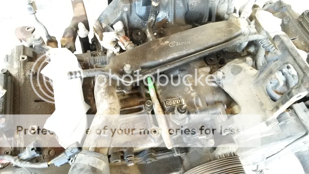

By the way, is there a flex section in stock uppipe? Turbo mount flange is kind of loose on mine and it feels like joint is somewhere under the heat shield, canít see. Wonder if it leaks..
Also question, does it makes sense in keeping stock heat shields? Mine are kind of reusable but they weight a lot.. I wonder if wrap works better or not?

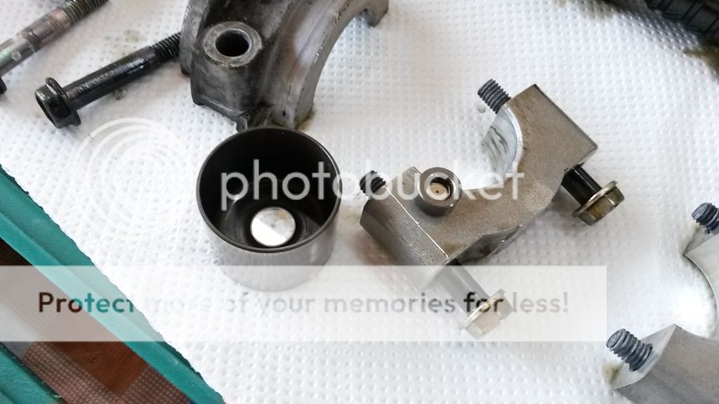

Finally after final stage of cleaning I managed to pull out valve cover from LH side (2+4).
Itís for sure STi, not HLA heads.

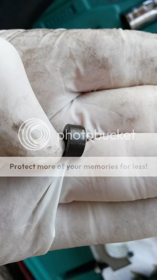

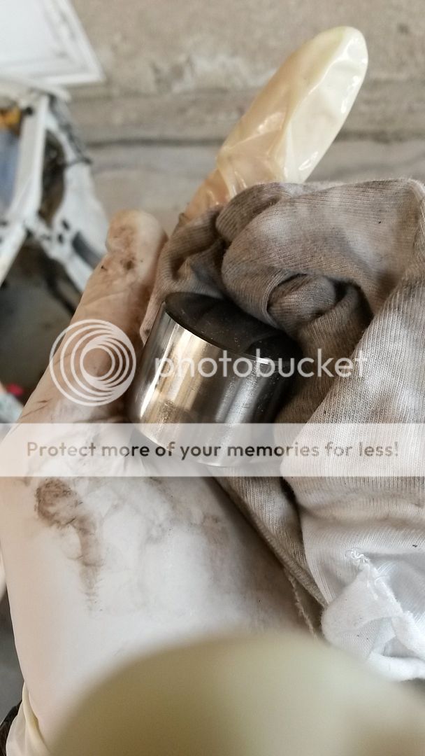

Shims are 9.65 mm (? my caliper is crap) diameter with 6mm hole on the other side and have numbers on them written by hand.
Buckets are 30 mm diameter. This one seems to have worst wear although sits a bit tighter than others.
Are these (buckets+shims) similar to V3-4 and later bits? because I never seen them but by part numbers V1-2 STi shim setup looks different and unique although similar by design.

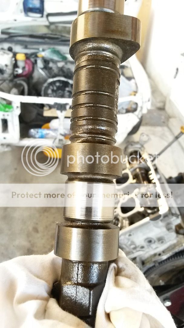

Cam journals are fine for me, which sounds funny because I never did anything like this before
I just never heard of anyone doing any polish/repair stuff on these, so I will just try to put it back together as clean as possible to not to cause more damage.
Exhaust cam, worst bearing:
respective cam journal
Intake cam caps, cam looks mint.
Still need to measure the other head and order correct shims plus some other stuff to put it together.

nice work. the shims you need to measure the inside were it rest on valve. They are rarely out of spec so just put them back exactly where you got them
you heads look like v2 sti heads. v3 and v4 are the ej20k engines with cloverleaf chambers, the valve buckets are different diamteres. the early wrx heads wre HLA lifters, were yours are shim under buckets sti heads. O dont see any closed deck casting marks on block, usually v2 sti's were closed deck
looking again i think i do see the casting. Thats a closed deck v2 sti engine. not sure if you knew that or not

Yes, I knew that it might be STi engine with closed deck block. But now it's finally confirmed.
I can't measure buckets since i don't have proper tools like micrometer. I have only basic cheap caliper which does the job for most of the time. So I'll trust the numbers for for now, but when I'll do second head I'll pull some buckets and give them to my mechanic to check and confirm sizing.
The clearances measured on LH head are too tight, around .17-.20 mm for intake valves and around .22-.28 for exhaust. The specs if I'm not mistaken are 0.25/0.35.
This is kind of strange because valvetrain was a bit noisy so I was expecting to see clearances above the nominal. Although as valve seats wear out clearances should decrease, so results that I got look realistic.
Will check second head and decide.. Maybe switch some of the shims to even the clearances a bit, or order some new ones.

One of the buckets was labeled withs some kind of permanent marker, that's number 35 on the bottom one:
