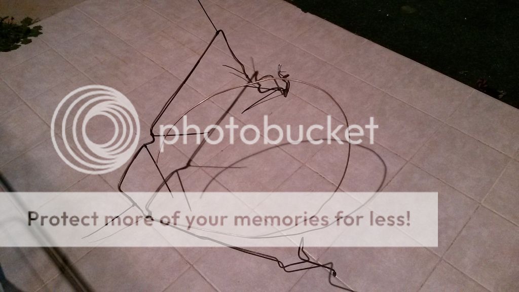

I almost finished with brake lines but got kind of short on supplies, so ordered more line tube... Basically I still need to finish making two front lines and assemble the system.
Here is longest line 50% completed using original one as a guide. Still needs to be cut to length and final bends, as well as second flare...
I wonder if this was a good idea since it's not 100% as OEM for sure, so I expect fitment issues. Maybe it would be better to make it from scratch. Engine was in the bay at the moment, so I thought it's a good idea to copy original line...
