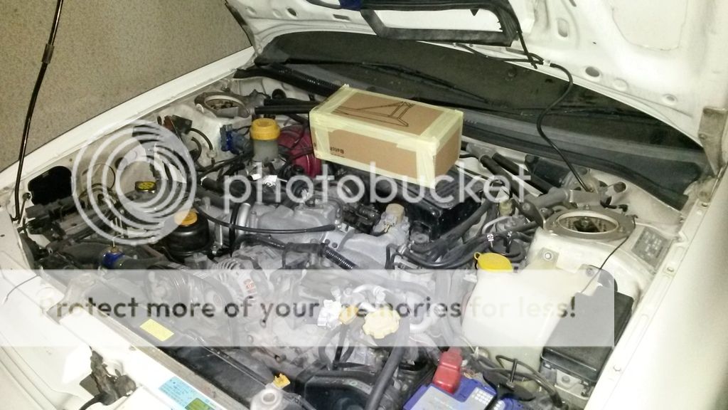

So, yesterday I got from work very excited to do something on the car. Finally. Probably had too much coffee. Anyway, I opened a hood and started thinking what to do.
Itís really hard to decide where to start. During quite long period without updates in my journal I managed to remove aircon compressor, so now it was a mess and after couple of month I hardly could remember where did I put my toolsÖ
BTW, that's WTA intercooler CORE mock-up from carton. Without endtanks.. V2 maniford is really not cool for top mount options...
Also my new tyres arrived - same Dunlop DZ03G as I had before, but in 235/45 R17. Size is a bit odd for GC8, but I have other problems to solve before it will become top priority.
