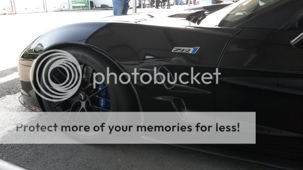

ZR1, really rare car for Cyprus. 2.0l cars are alreay quite expensive in taxes (road tax is calculated from displacement) I thnk it's annual toad tax is about the same as price of my car.
I'm pretty sure that this car is the same one Iast year. I had beaten his time by few hundreds of second with my record time on last event (1:12.73). His best time on single event he took part in was 1:12,78 if I'm not mistsken. I'm pretty sure he did that race just for fun, on oem tyres and wasn't really competing, just testing what car can do. Then it used to be yellow on chrome wheels, now car is black on black wheels, has michelin cup tyres, aggressive allignment, maybe something else. Anyway, it's time now was 1:09.36. I think it might remain the record for our class in 2015 because driver of this beast is participating in serious motorsport events outside of Cyprus and really knows how to drive
I also don't expect to see it in competition again this year, again, it was for fun, I think. In fact he left after first session.

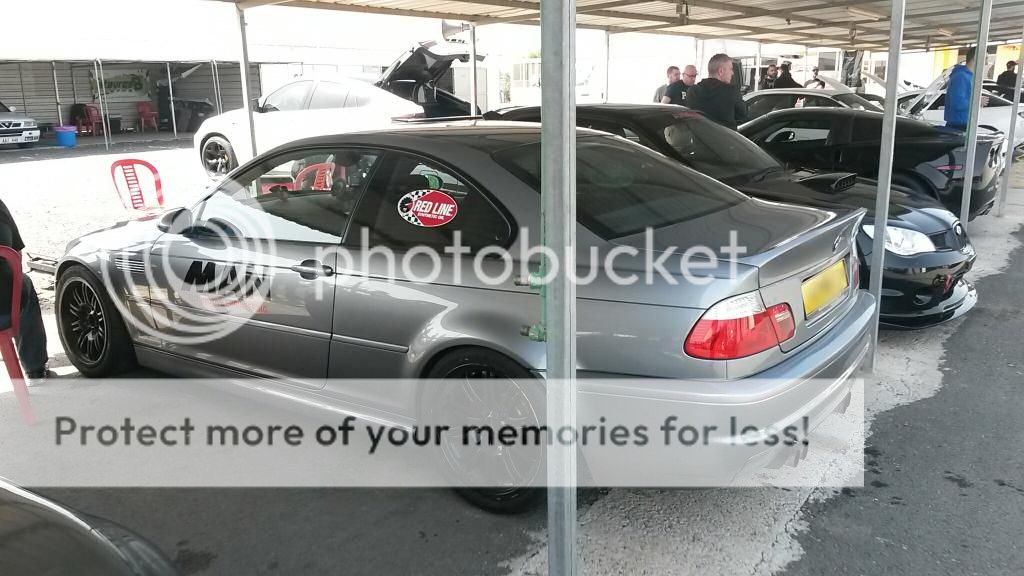

M3 CSL
Original CSL in perfect condition. Champion in 2wd class in previous years. Wasn't participating last year though and this was his first race on semi slicks. On slicks this car used to run low 1:09.xx laps, on street legal semis he did 1:12.1 this time

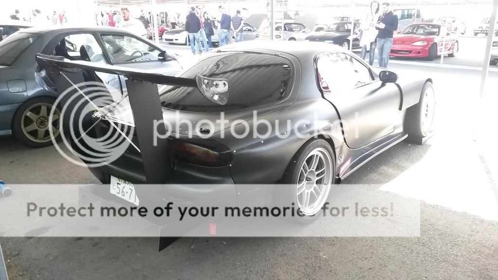

Always loved RX-7s
Has LS inside... kind of disappointed, i'd loved to see rotary power.
