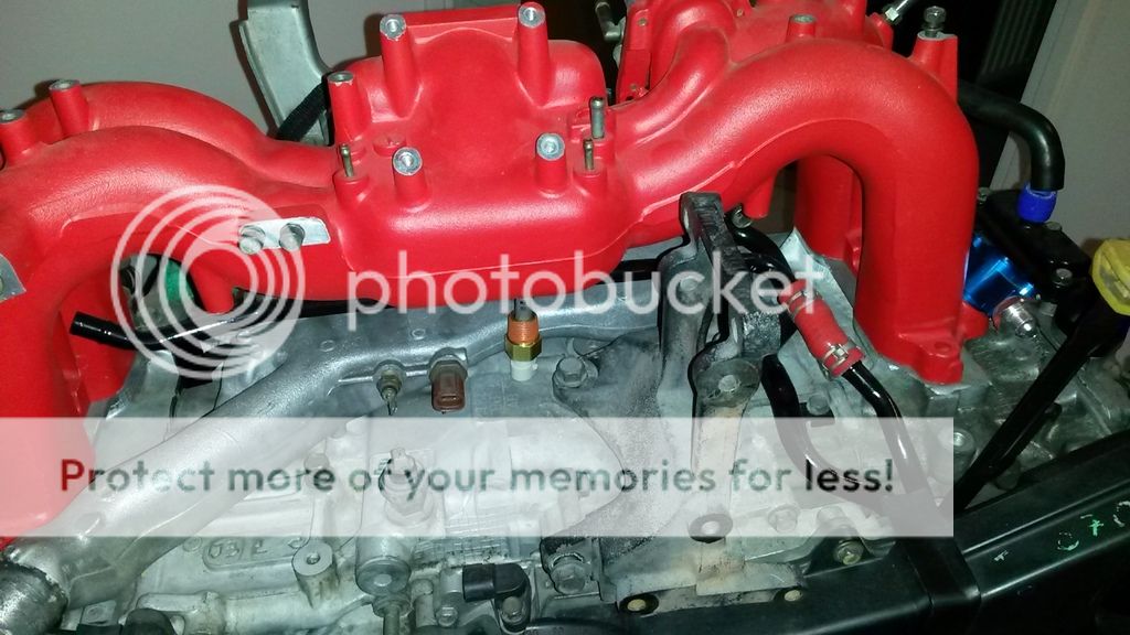

I tried to put the manifold on top of the engine and it looks that sensor can be mounted on the bottom. Here:
Just enough room to get it in and out with manifold installed and I can't see any problems with the connector as well. Probably will be easier to tap because manifold is flat there. But I still want to try spot on the top. I believe it's the best spot in terms of airflow although wall thickness and rounded shape may require welding the bung in...

Tapping the bottom of the manifold is a bit sketchy. Follow Terry's advice and you should be good.

Top feed kit looks fantastic, but I got all my stuff 30% cheaper incl hose and an fittings . And my manifold is basically 97-98, not sure it will fit.
Regarding that plug - that's interesting. Plug has roughly 15 mm diameter, so should be just fine. And thickness there is much better. If only it was closer to the center... I also don't know what's under the plug. Is it for machining of some channels for IAC? Or for casting purposes? Will it be enough airflow there?

Couldn't find the correct drill so ended up giving it to friendly shop
As you can see, that plug thing is no-go because it's basically for ICV channel, it doesn't have free access to the plenum.
