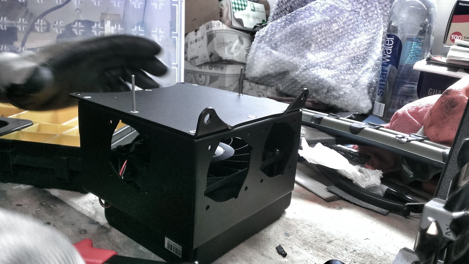

Ok... The heater was test fitted.
The screws were removed in favor of flush aluminium rivets..
This allows it to be mounted flat.

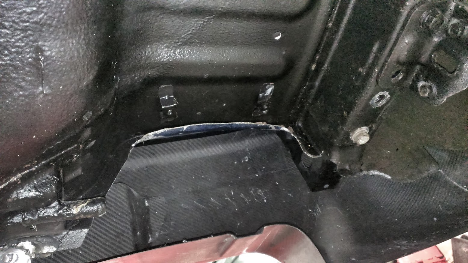

Now onto the hood latch.
Took some balls (at least for me) to cut that JDM aluminium hood.
Pin placement seemed OK but that wasn't the case..
We had to fiddle around to get it properly aligned.
Balls out.. and I cut the other latch.
Lower rad beam was removed in order to properly align the intercooler and radiator..
Up close and personal with the risers to clear the STI radiator.
Finally the seat and steering column were mounted to test the placement of the new hydraulic hand brake..
