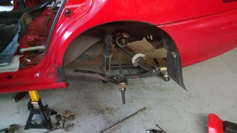

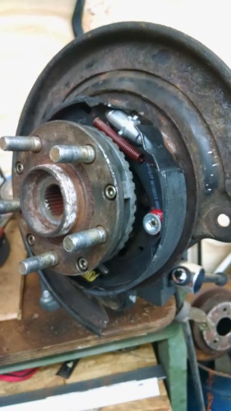

been a while, finally got around to doing a rear disk swap, but it also included a few new bushings in the rear to go along with it.
also decided to install a set of kyb gr2 with blue eibach springs and group n top hats and goodridge ss brake lines thrown in for good measure
hopefully i will get rid of the crappy ride the gdb springs were giving me, i keep rubbing from the horrid roads around here.
(is this how you get to the rear diff drain plug?)

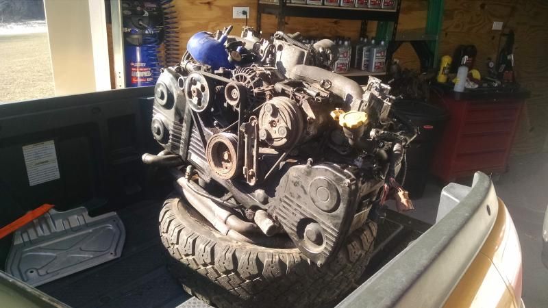

then this followed me home, 02 wrx engine with all the supporting goodies

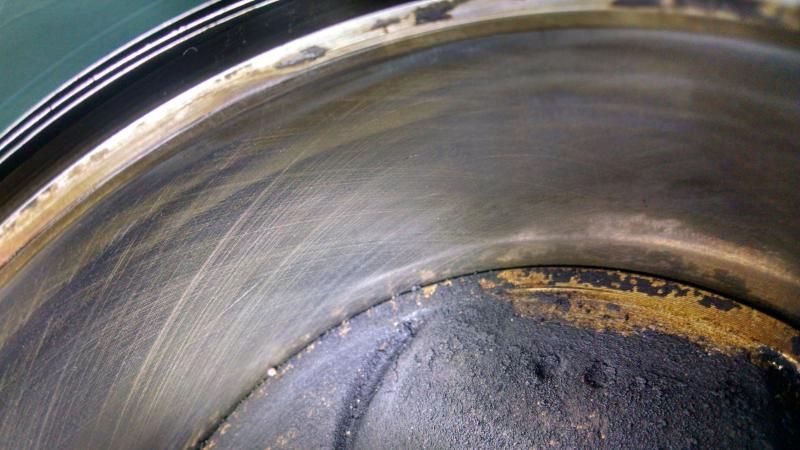

did a set of head gaskets and reseal on a 251 out of a 2003 forester with 247k on the clock.
was leaking coolant into the one chamber and leaking oil like crazy via the bad gaskets.
you can still see clearly the cross hatching on the cylinder walls and the engine sounds like it only has 100k on it.
