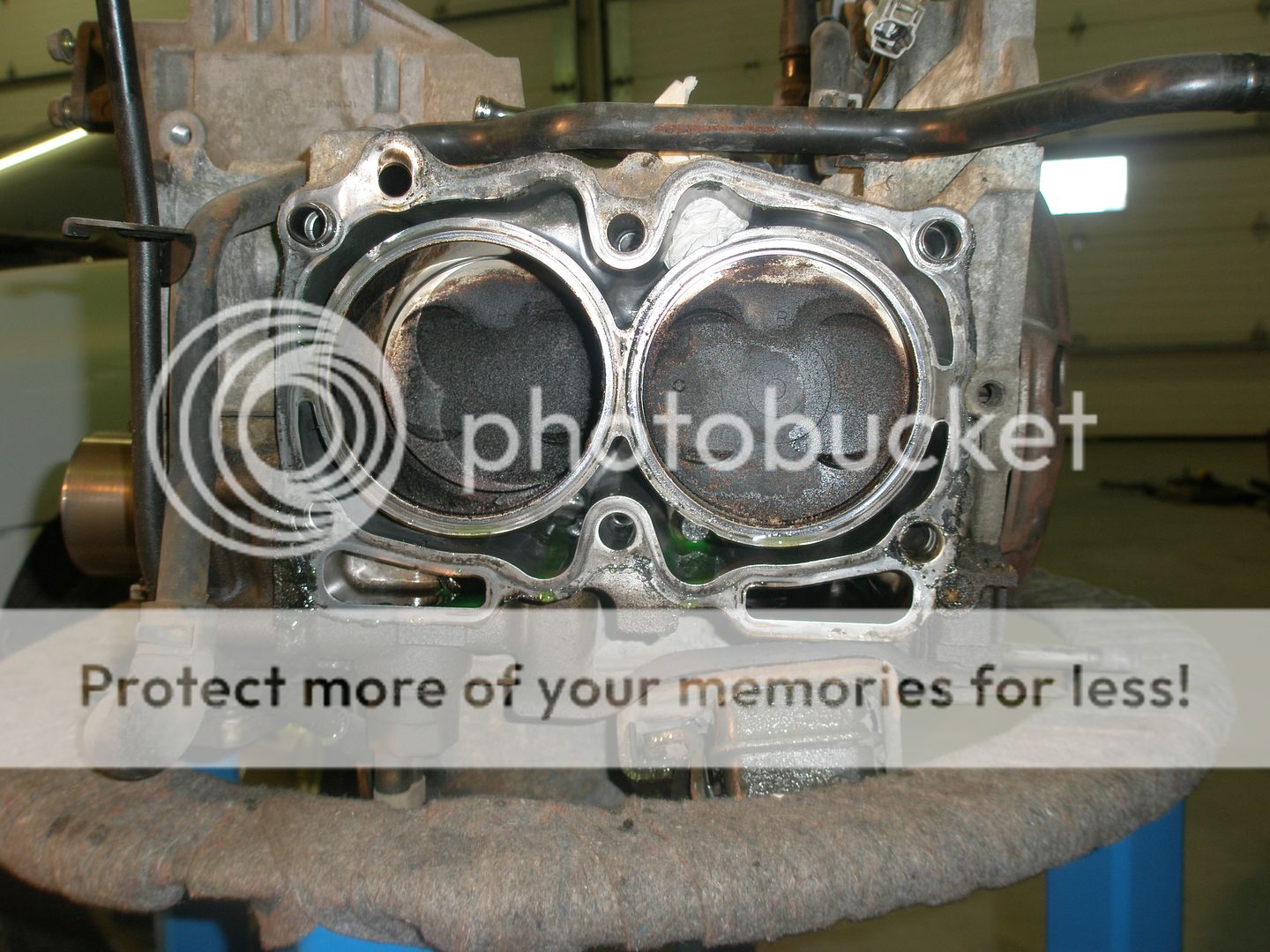

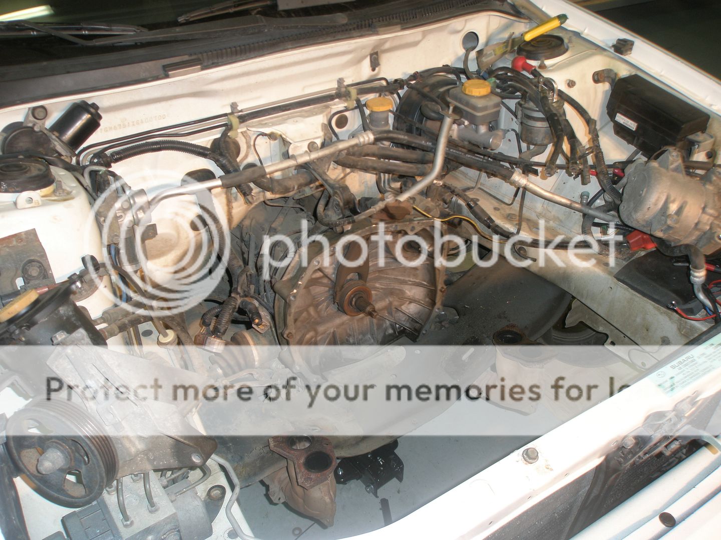

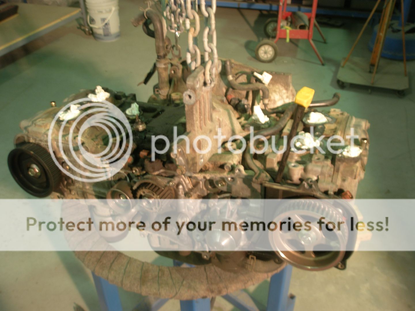

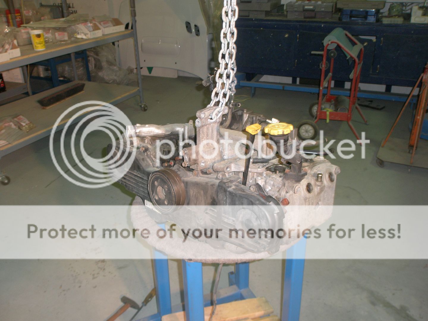

Some pics of the Timing Belt and Head gasket change.
I pulled the engine according to the DIY engine removal thread DIY: Engine Removal which worked out great, while I think I could have done the repairs while the engine was in the bay it still would have been alot of work and harder to work in that small space.
Drove it in the shop on blocks and under the roof hoist, Got some buds to help me remove the hood, from there its basically a one guy job.
Following the instructions on the engine removal threead with my laptop beside me step by step proved very easy, I took pictures along the way incase I hit a point where I couldnt figure out how to re-install the engine later, but that didnt happen
I left the header attached mainly because I couldnt remove the bolts at the Cat but it didnt prove a big obstacle, mostly at the engine mounts but after the manifold side bolts were taken out it moves freely enough.
Shot of the motor with the intake assembley taken off. Make sure you remember how many wires you dissconnected and where. Makes it way easier to re-install later, also cover up those internal holes to prevent a loose screw or something falling into the heads or block.
I did one head gasket at a time instead of removing both at the same time, it only took a few hours to do the actual "work" that had to be done. The write ups on the head gasket replacement and the Timing belt replacement in the DIY forums were done really well and helped me tons. This saved me 14 quoted hours of labor at the nearest Subaru dealer and $2200 in costs, The gasket and timing kit were sent from 420Motorsportrs and everything fit perfectly.
Engine goes back in the bay, after having some trouble I figured out the clutch cover was jammed between the engine and tranny. after that it went slick.
Fired it up and what do ya know? it runs! Its below -20 C up here now even in the day and there have been no issues with the motor (once its running) Getting it started while its this cold has been harder but thats normal for most older vehicles up here. The Rad doesnt pressure up now and the engine runs great. Props to all the guys who helped me on here.
