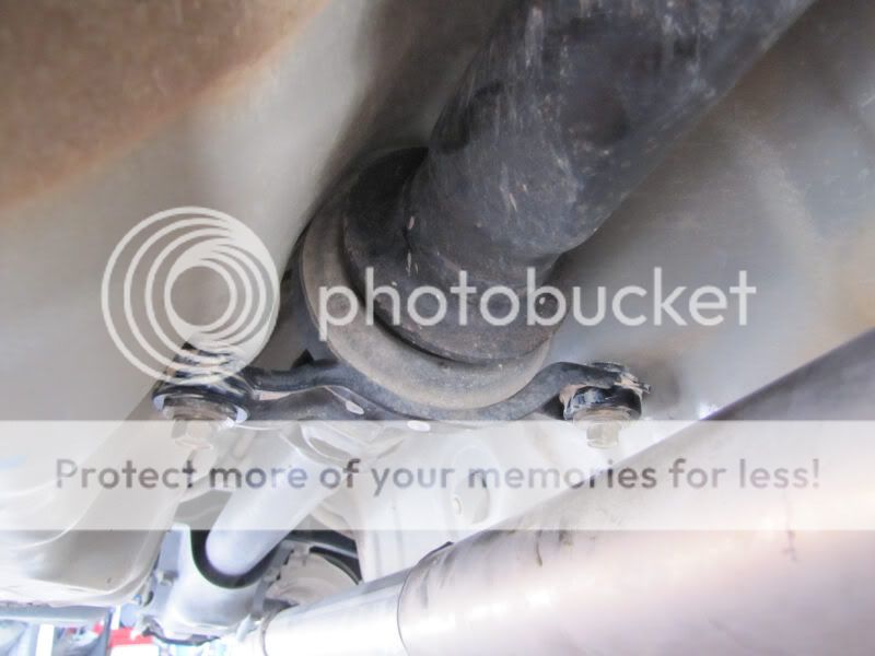

Got up early and installed the Beatrush Propeller Shaft Mounts. Its a pretty straight forward install, but for those of you that dont know how.
Jack up one side of the car as far high as you can get it and use jack stand support.
First your gonna have to remove the heat shield using a 12mm. There are 4 bolt holding it up.
Once the shield is removed, uninstall the two 14mm bolts that hold the center of the drive shaft.
Heres a comparison of the two mounts. Its also very handy to use the swivel ratchets to get in those tight spaces.
The next step is to grease up the new mounts and install. The grease also comes in very handy because it holds everything in place while you screw in the bolts.
This is what it should look like when installed.
