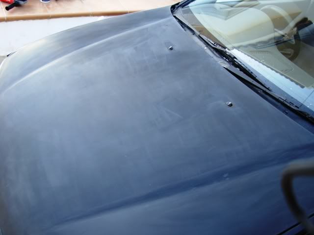

Here's a wet sanded hood:
Once you are done wet sanding (weather it be just one little spot or your entire vehicle) wash your car to remove any dust.
Grab your DA and some pure polish and polish out those sand marks! Here's a couple 50/50 pics of the marks polished out (if you do 2-3 passes and swirls/scratches are still visible then use a compound and re-polish):
