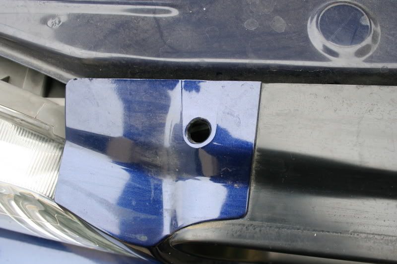

Step 1: Removing the grille.
Open hood and remove the grille. This is very simple to do. There is one hole on each side of the grille and has a tab inside. You will need to stick a flathead into these holes. First, push then pull the grille out. Repeat for other side.

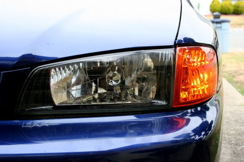

Final results:

I love this set up.. amber corners + black headlights +1 for the write up!
