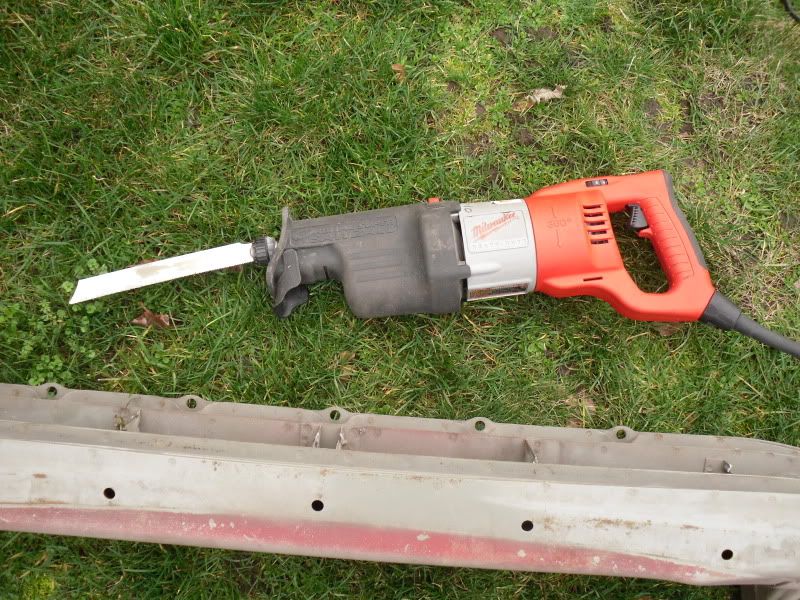

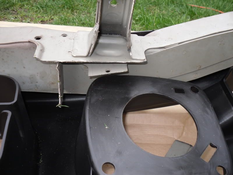

1. Here i have the Regular ol L bumper beam. this is what im going to use with my RS bumper Cover
2. I rented a Sawzall/reciprocating saw from Home Depot for 15$ for 4 hours(blades are separate)... your gonna want to buy 2 or 3 heavy metal blades, yours gonna want to get the 9 inch blade.*i used 2, but bought 3 just in case.*

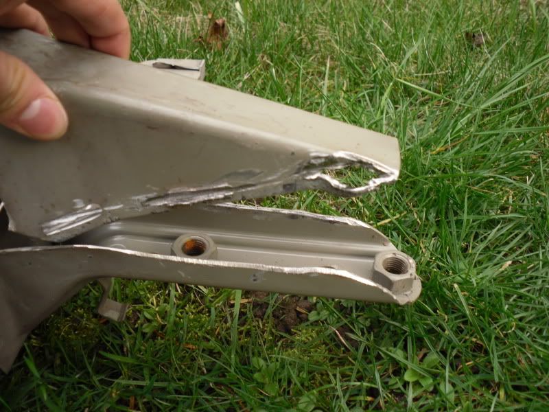

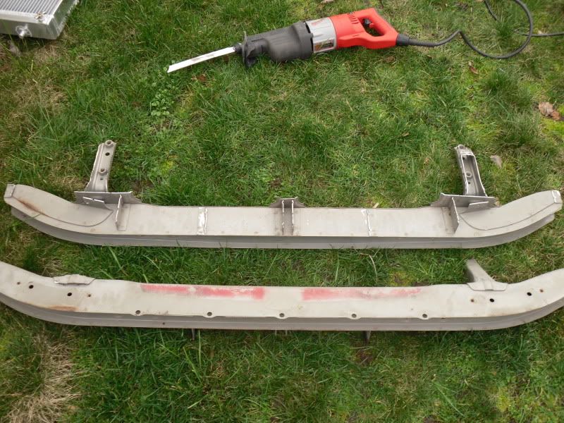

3. Cut the directly in half Horizontally.
4.The mounting points are kinda hard... but pull the trigger all the way on the saw and its no problem. Cut along that weld area.. or close to it.

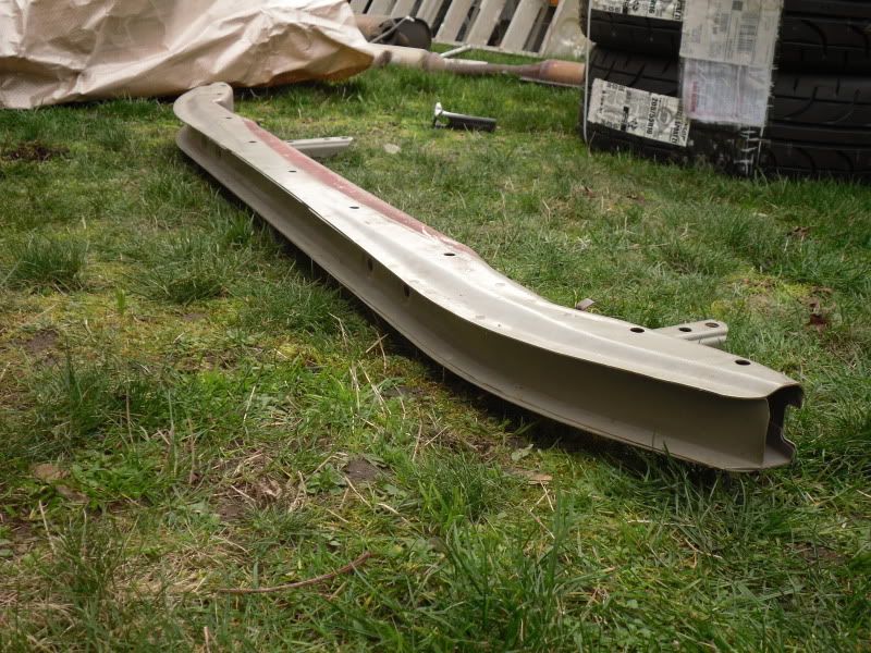

5. should turn out something like this, you may use an angle grinder or something to file it... only if your tedious about sharp edges.

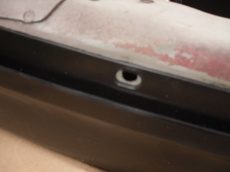

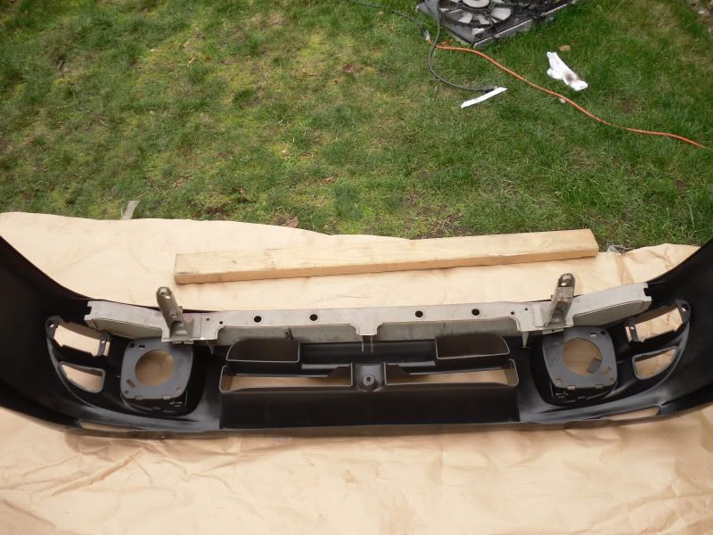

6. it will fit PERFECTLY snug into the bumper... even WITH the fog lights.

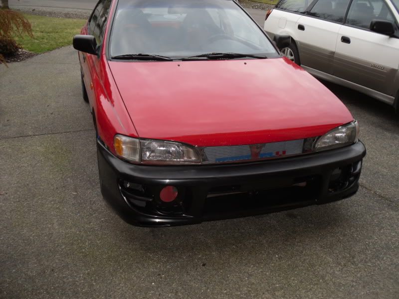

7. this is it on my car... no it was not bolted on... i just bolted the Beam on and slide the bumper cover on... everything looks perfect to me ..
